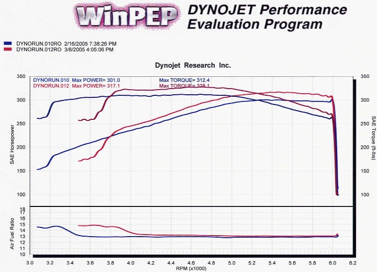

Here it is, the before and after dyno of my Pacesetter long tubes with OR-Y. Picked up 16 HP and 16 ft-lbs of torque. Not to bad considering I am still running stock air box, tube, and filter. I figure I can squeeze out a few HP with a CAI.

nice #'s man! like you said with a CAI it will probably wake up. how is your exaust pipes set up? are you running a converter with that cam? thanks man...
