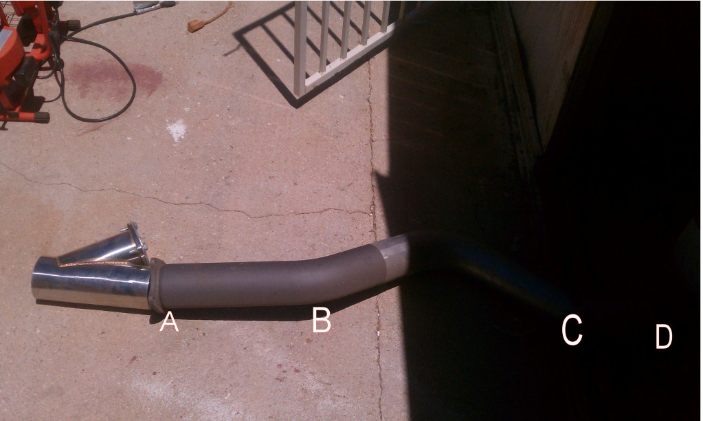

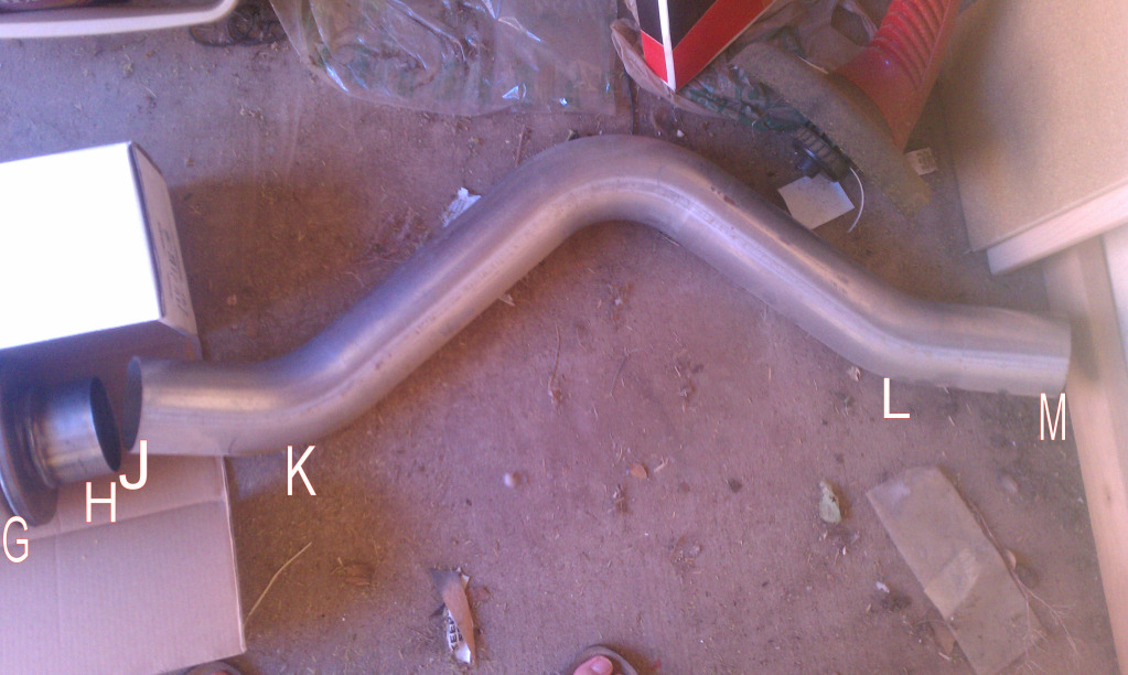

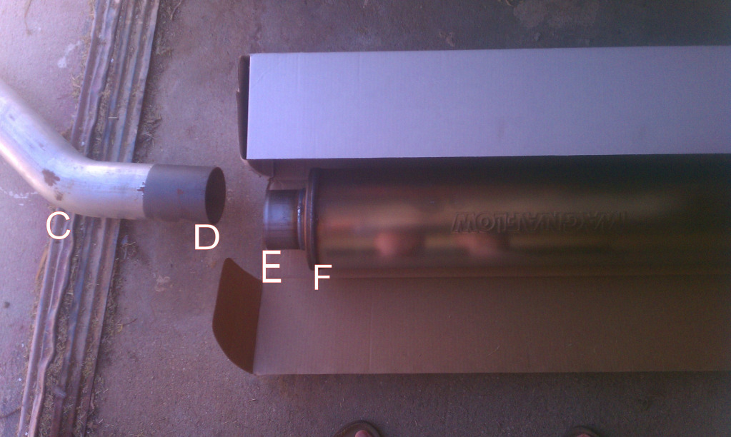

so I got some measurements from my Dmax exhaust. Here is what I have
the measurements:
A-B= 16"
A-C=38"
A-D=49.5"
E-H=36"
F-G=30"
J-K=7"
J-L=32"
J-M=40"
A-M=127ish
The cutout is 10"
the 3-4 merge is 5.5"
I will have to cut about 1" off of A-B because of the flange.
The front pipe goes under the frame cross over. I would like to keep the exhaust as hidden as possible.
I have 4 options:
1: I can install everything like it that and run the 1 muffler.
2: try and fit a 14" body, 8" round, 20" overall magnaflow between the trans and tbar xmembers, there is just enough room, but am unsure if the front pipe will fit. I would have to cut it all the way to B.
3: I could buy about 4' of 4" tubing and run it strait like how smokeshow has it.
4: same thing with the 4" tubing and try and fit the smaller muffler in the same spot as earlier.
Any other options? What would yall do?

I would start with the 30" and see how you like it. Worst case, you can put that 14" muffler like how I had it with the rear mount turbo. As the 4" bent over the axle, right after the bend I put that muffler there, so it was at about a 30 degree angle with the ground. And then I put a small piece of 4" off the muffler to exit it from under the bed. Would be a quick and easy way to add the extra muffler. I don't think I have any pics of it, but I could show you.
