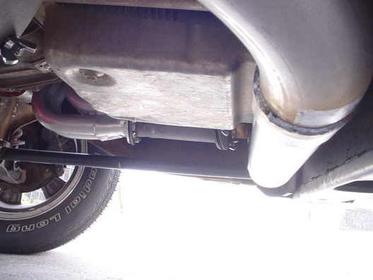

Does anyone have an underside pic of the LT's with the Y on? I need to see how it runs.

this is what I have not much
this isnt the pacesetter y-pipe its a custom built one but it runs the same as the pacesetter.
