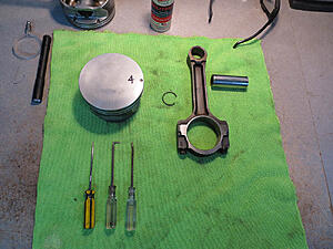

I believe 04 was the transition year for the better full floating GEN IV rods, some got um some didn't. In 2005 even the 5.3's had the GEN IV rods.
The LQ9 was my first engine build with floating pins... and of course I had to take them apart as an excuse just to clean the pin and the pin bore lol

2004 calendar year for all LS's getting full float rods. Easy check.. you have 10 mm valley cover bolts it's the older multi length head bolt block and press fit pins. 13 mm valley cover bolts is the newer equal length head bolt block and full floating pins. There may be the odd exception but it's been fool proof with me. LQ9s always have had the full float rods.. right since 2002.

The valley cover bolt size is a new trick for me, thanks for that
