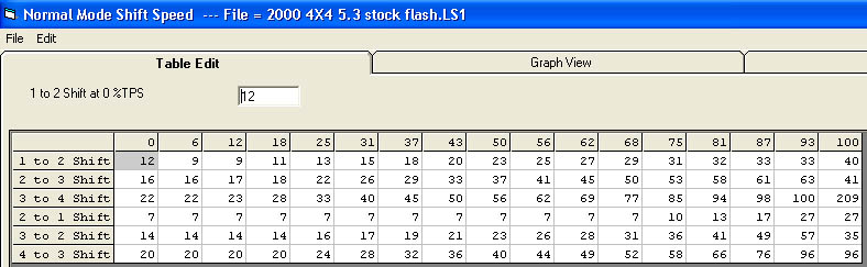

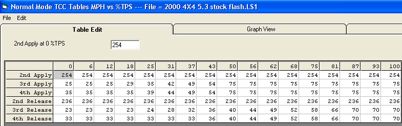

i'm quite certain it's the torque converter not unlocking soon enough. Mine is doing the exact same thing. I brought it to a trasmission shop last week, they said it's normal. Well, i guess I don't want normal. I want it to respond faster. As soon as i hit 55mph, it locks up and feels like i'm driving a 4 cyl unless i stomp on it to get it to downshift. Really a bad, bad feeling.

Here is the TCC lockup and release table for a stock 2000 5.3L truck. It takes alot of throttle to get that thing to release.
Numbers on top are TPS% and the numbers in the chart are mph.
The downshift jpeg shows the stock upshift downshift conditions that have to be met in order for the upshift/downshift to take place.
