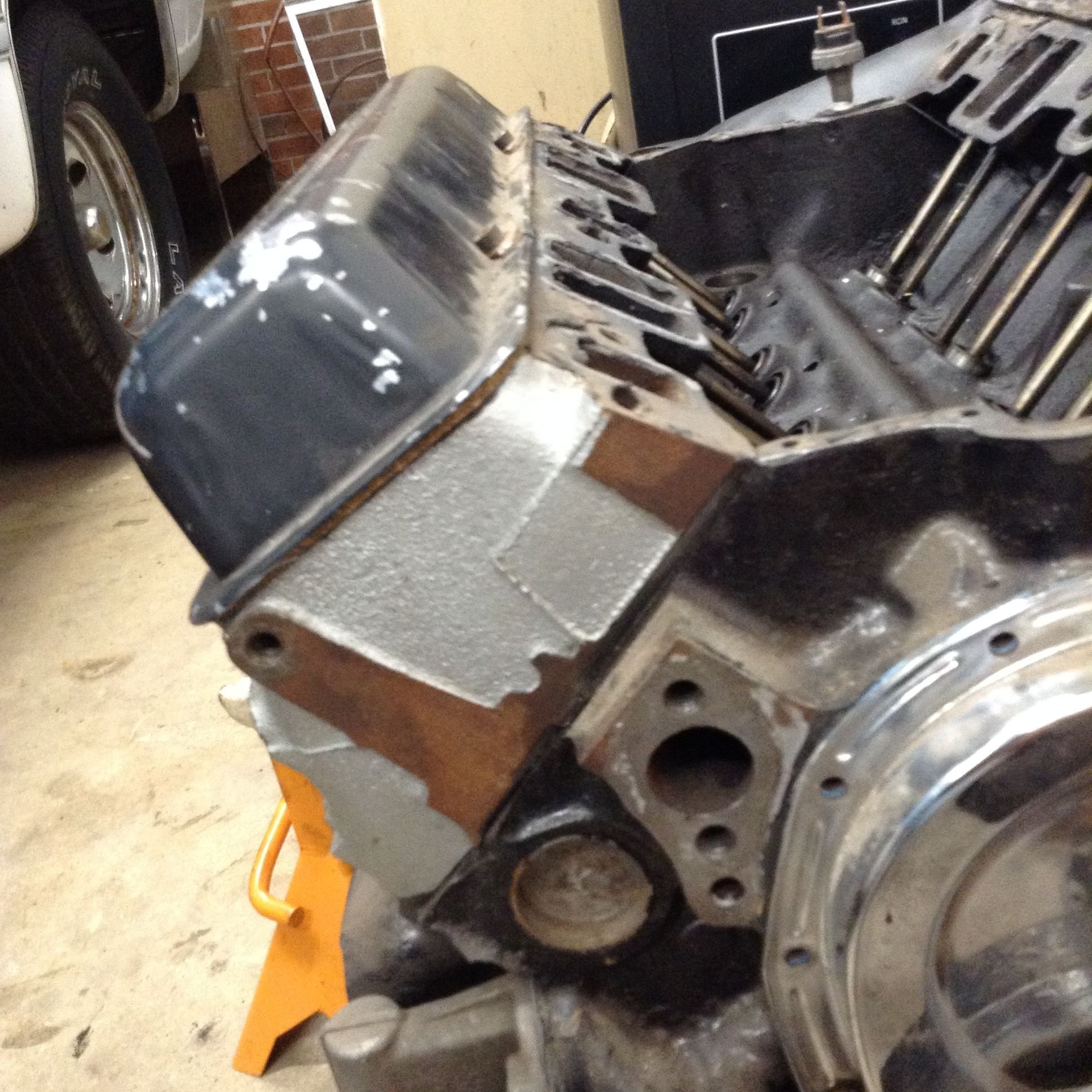

Need info on these heads on a 350

Block casting looks like 3970010
Standard 350 from 69-80 in 2 or 4 bolt main.
Go here when you pull the valve covers and retrieve the casting numbers. Chevy Small Block V8 Casting Numbers - Mortec

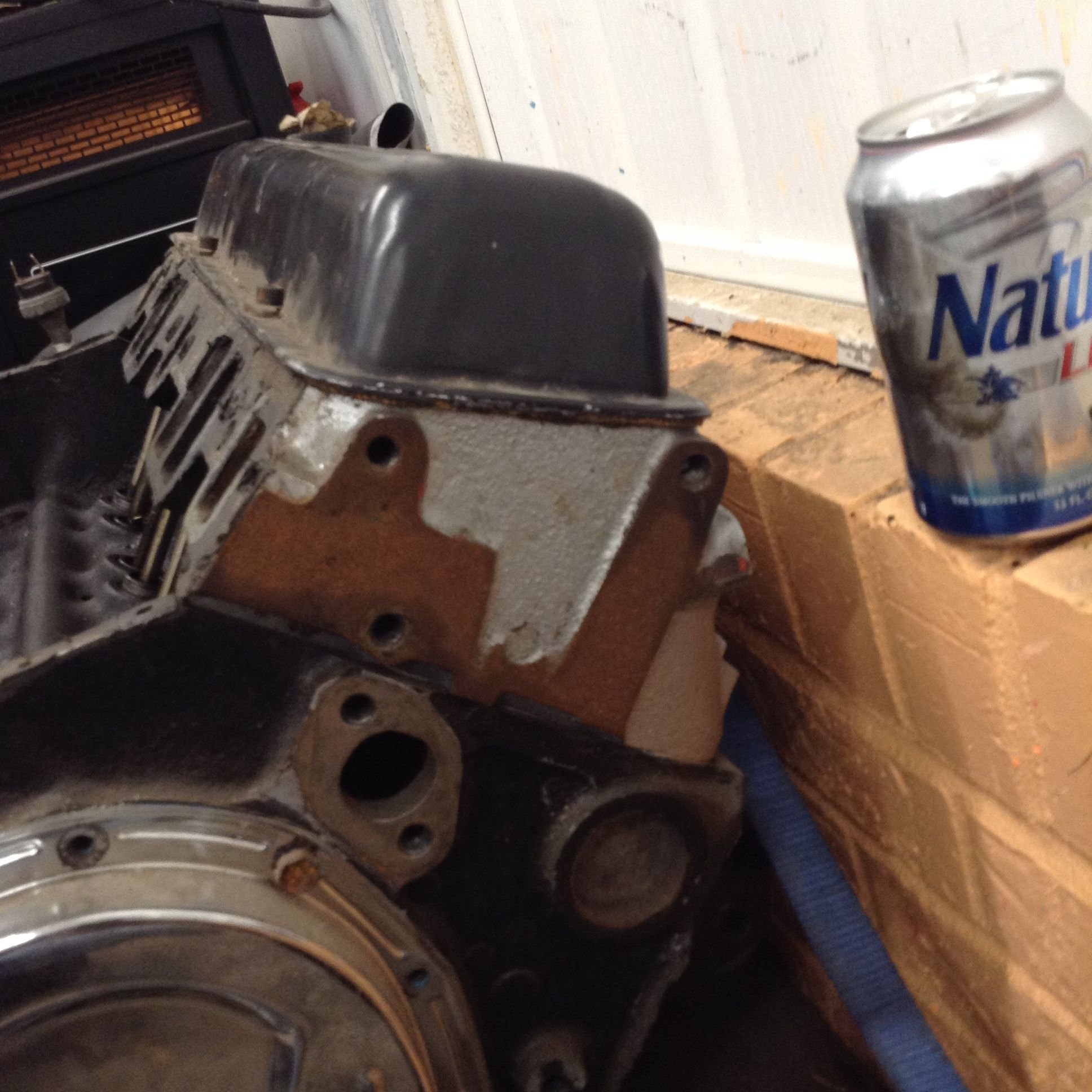

Looks like 416's to me what yall think

Not easy to read but it looks like. a 9 not a 6 but this is the closest I could find based on the second picture.
14014416...80-86...305..........1.84"/1.5" valves, 58cc chambers
