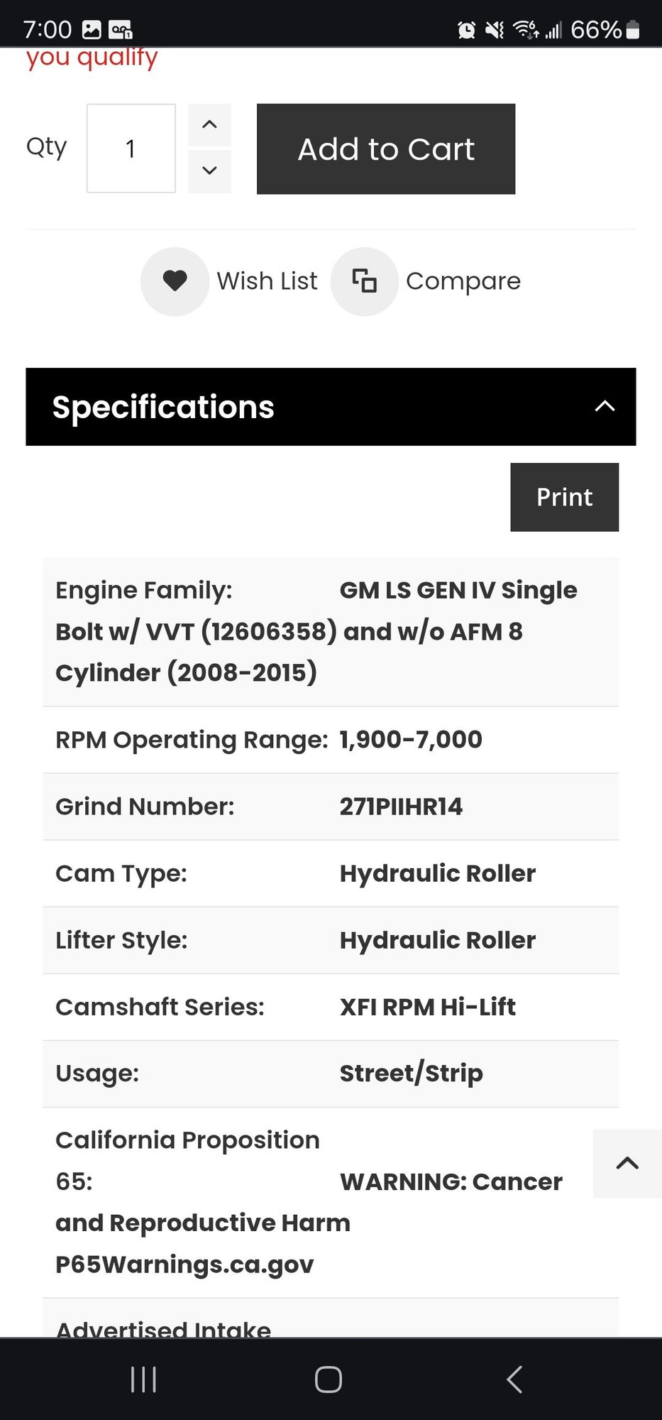

Was thinking going with pac 1218s with tool steel retainers and then a semi mild VVT cam for now and see how i like all the bolt ons then a couple years down the road change see if i want to change it up with a blower and a diff cam.
What do u think of the comp cam below for a NA application? This seems a tad milder than the TSP
-ported heads
Lt headers
Dual exaust
(Maybe ported TB?)
