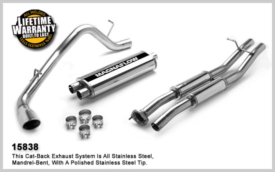

I'm kind of in the same boat right now. I have an 05 Sierra Denali CC/SB AWD and would rather pay for a custom exhaust before buying a Corsa.
I have been talking with a sales rep with Magnaflow and he sent me a diagram of the catback kit#15838 for the Chevy SS.

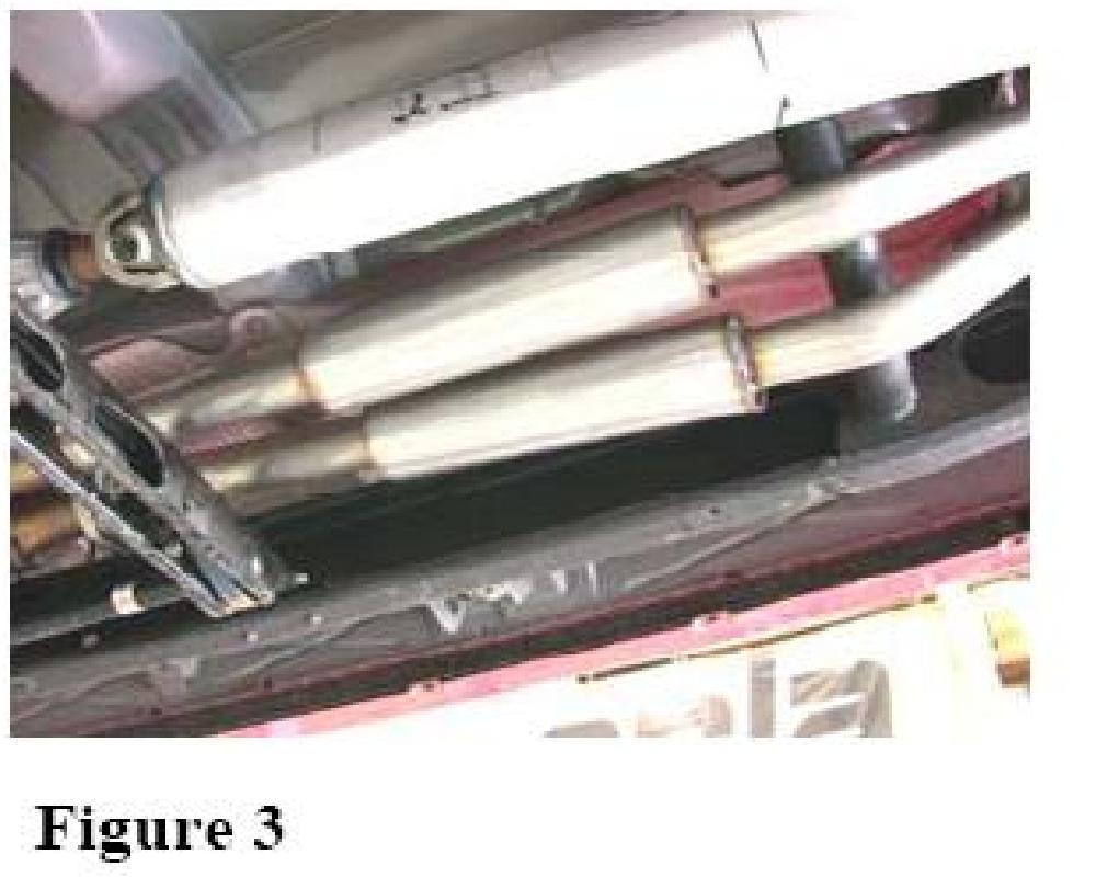

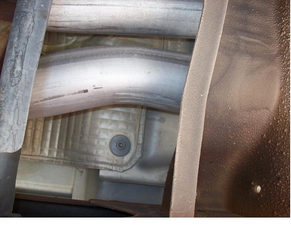

The only problem with my truck may lay with the transmission crossmember. I also attached a picture that I got from Borla's website and it does not show the added crossmember that I have.
With yours being 2wd your crossmember setup may be different?
Attached Thumbnails Need advice for a Catback for a 2006 Crew Cab 2WD-15838_lg.jpg   Need advice for a Catback for a 2006 Crew Cab 2WD-chevy-ss-borla-exhaust-large.jpg   Need advice for a Catback for a 2006 Crew Cab 2WD-100_0107-1000x800.jpg

Unfortunately it is not true for all exhaust systems. I ended up giving my Borla to my dad when I traded in my ECSB and bought my CCSB. They have alot of similarities but the ECSB has a carrier bearing crossmember and the crewcab does not but it has another crossmember that prevented me from using my Borla system. I think my Magnaflow fits both but if I could have kept the Borla system I think I would have been much happier.
