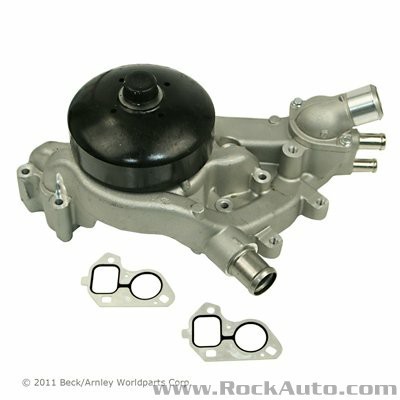

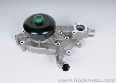

I like the look of the NNBS waterpump over the older style because of the placement of the water neck. I am curious if all the mounting holes and tensioner mount are the same.
NBS
NNBS

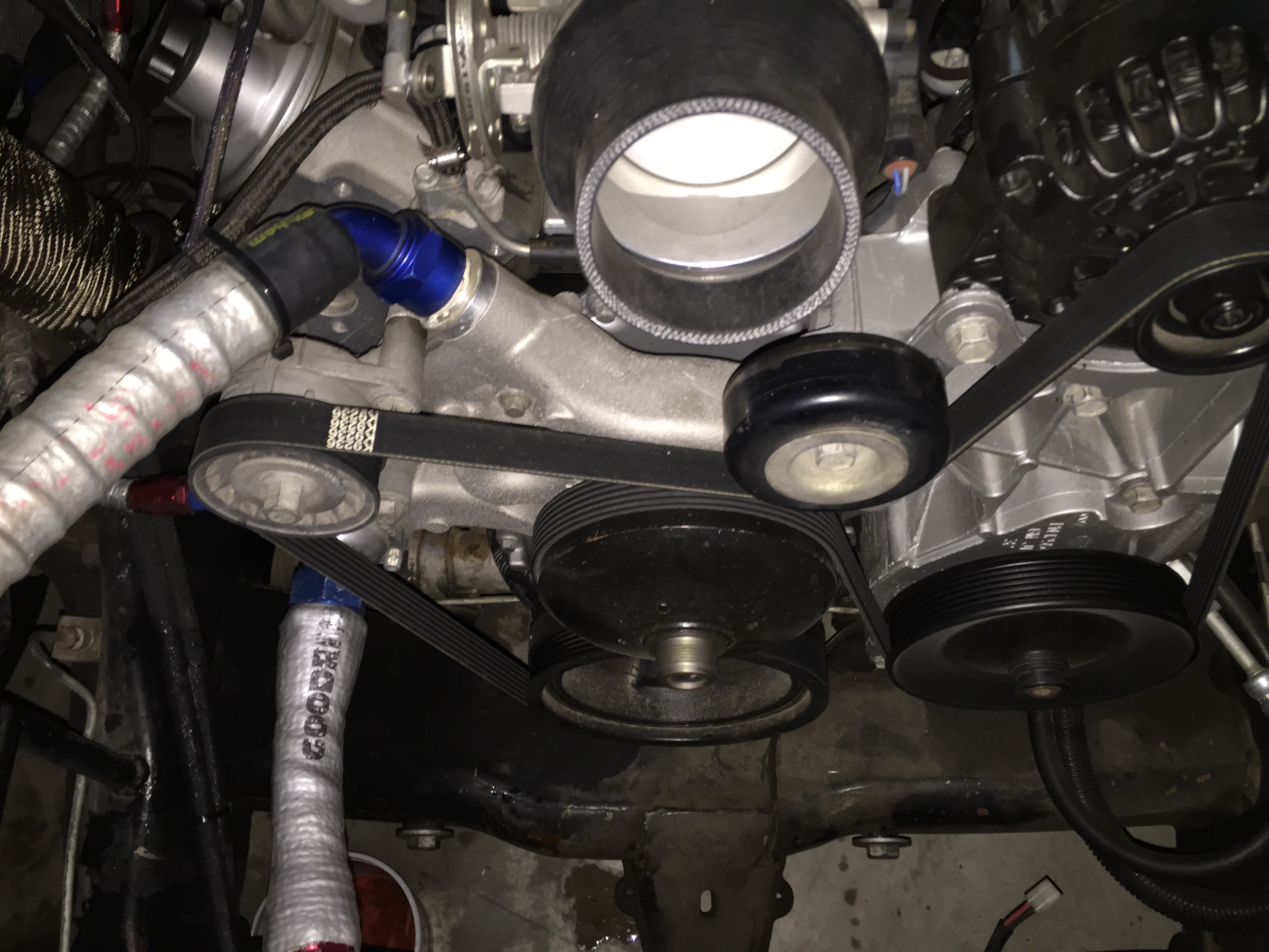

worked for me....but im using diff. radiator hoses due to diff. radiator. T-stat and tensioner change over fine...

Here u go.
Attached Thumbnails Are the NBS and NNBS waterpumps interchangeable?-image.jpg

The mounting holes for pump to block are the same and i believe the tensioner is the same as well.
