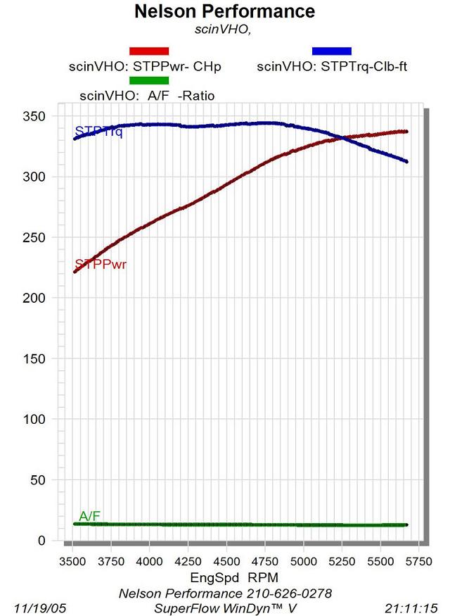

I'm a little excited about this , I feel it's pretty good for a cam & bolt ons.

Could you please inform us of the mods, cam specs, type of dyno, peak figures, and if it was tuned or not? Also, it looks like you could of run up the rpm a bit more and picked up a few more hp.
Looks good from what I can tell.

Sorry about that. Mods are:
TR224/224 .563/.563 on 112LSA
Comp 918's
Thorley Headers
Magnaflow Cats
Flo-Pro HD muffler
'05 efans
160* tstat
'05 K&N intake
Nelson Tune
Peaks:
338 hp @ 5,666
344 ft/lb @ 4,763

Cool
Those numbers look very good for the mods you have.

Yeah, the numbers look pretty nice for your setup!! I think you could maybe get a little more RWHP.

dyno is a superflow dyno....
good numbers by the way

Great results,how is the driveability?Did the HP fall off past 5600 RPM?
