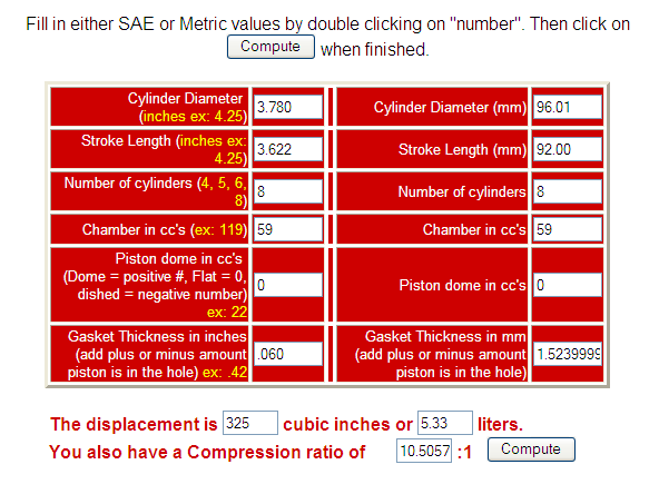

Can someone please look this over and validate it for me?
I think I have figured out that I need to lose 5cc's from the 64cc chamber of the 243's.
So if I wanted to get down to a 59cc chamber I would need to mill these 0.030 correct?
Which would then by that chart, put my CR at about 10.5:1.
What is the maximum tolerance of these heads? Can I safely mill them?

For every .007 you mill you'll lose close to 1 cc.......... You'd need to mill .035 off the heads to lose 5cc or close to it...

Ok cool. So if I wanted 58cc chamber I would need to mill .042?
64 - 58 = 6cc
6 X .007 = .042
This would put me at close to 58cc's correct?
Can I safely mill my heads .042?
