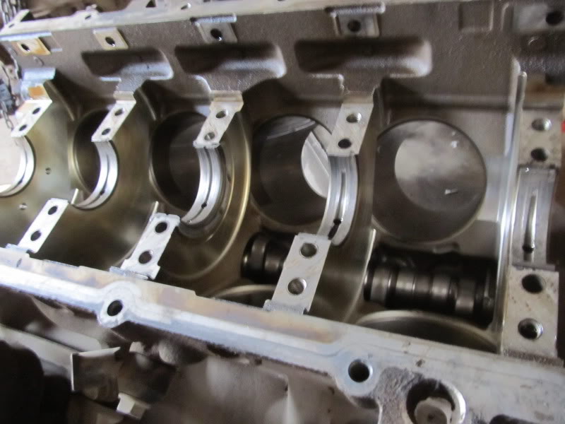

sand man May 14, 2012 07:03 PM

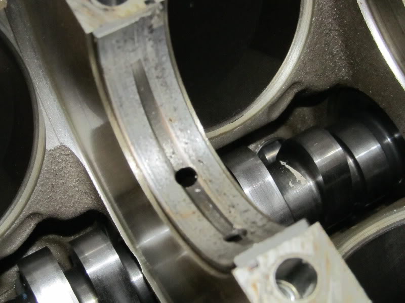

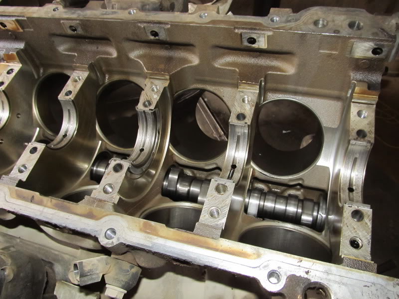

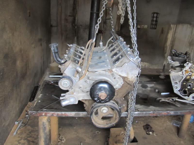

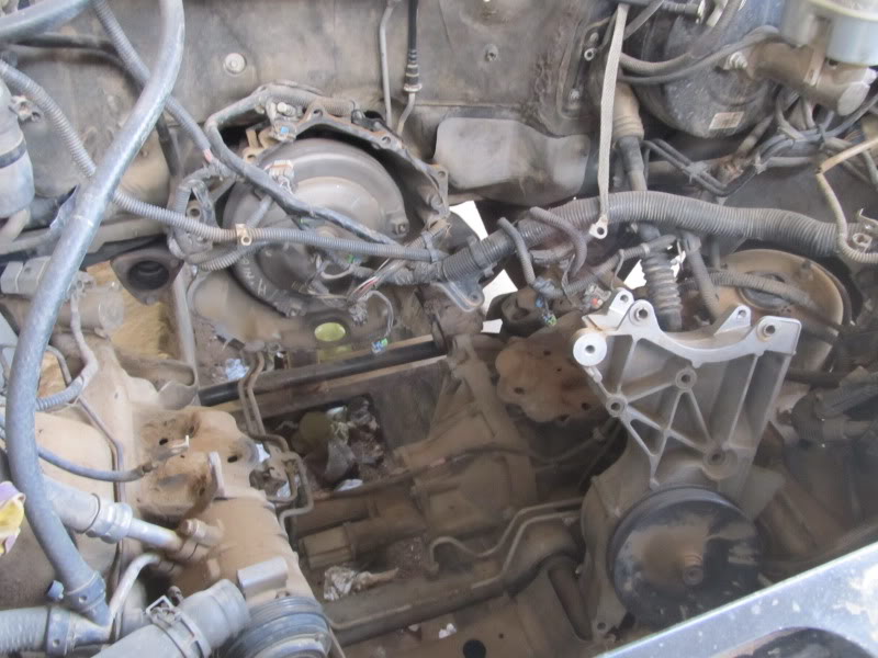

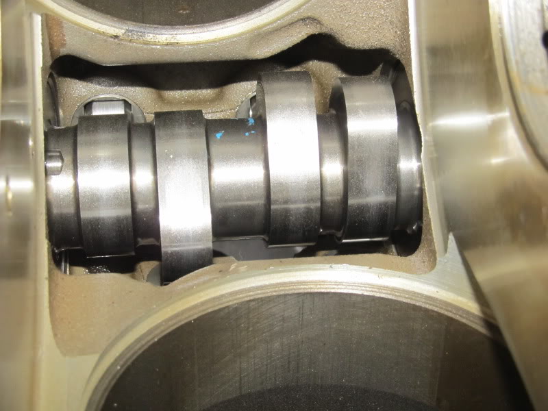

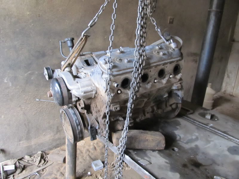

12 Attachment(s)
this is my old motor
if you can see any damage that i messed please point it out
Attachment 137192

the LY6

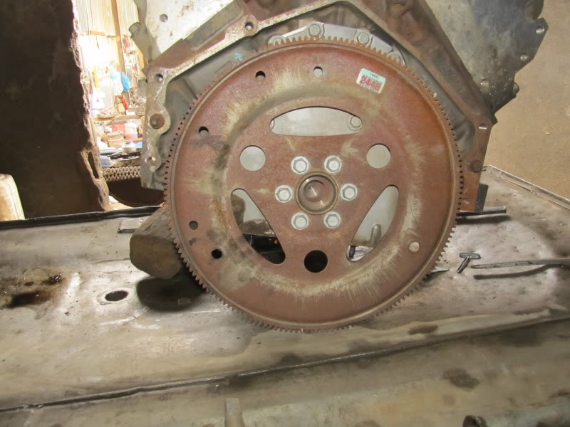

sand man May 14, 2012 08:00 PM
BTW can i use the flexplate upove on my 6L80 converter or should i use the 5.3 plate
