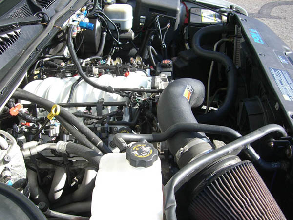

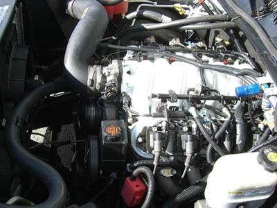

i paid like 175bucks for my fuel rail, ebay is friendly, car intake, car injectors and vette rail sit right at home in this engine bay
Attached Thumbnails LS2 with 90mm TB or LS6 intake???-cimg0319.jpg   LS2 with 90mm TB or LS6 intake???-cimg0320.jpg
