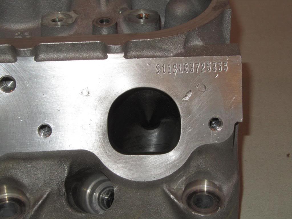

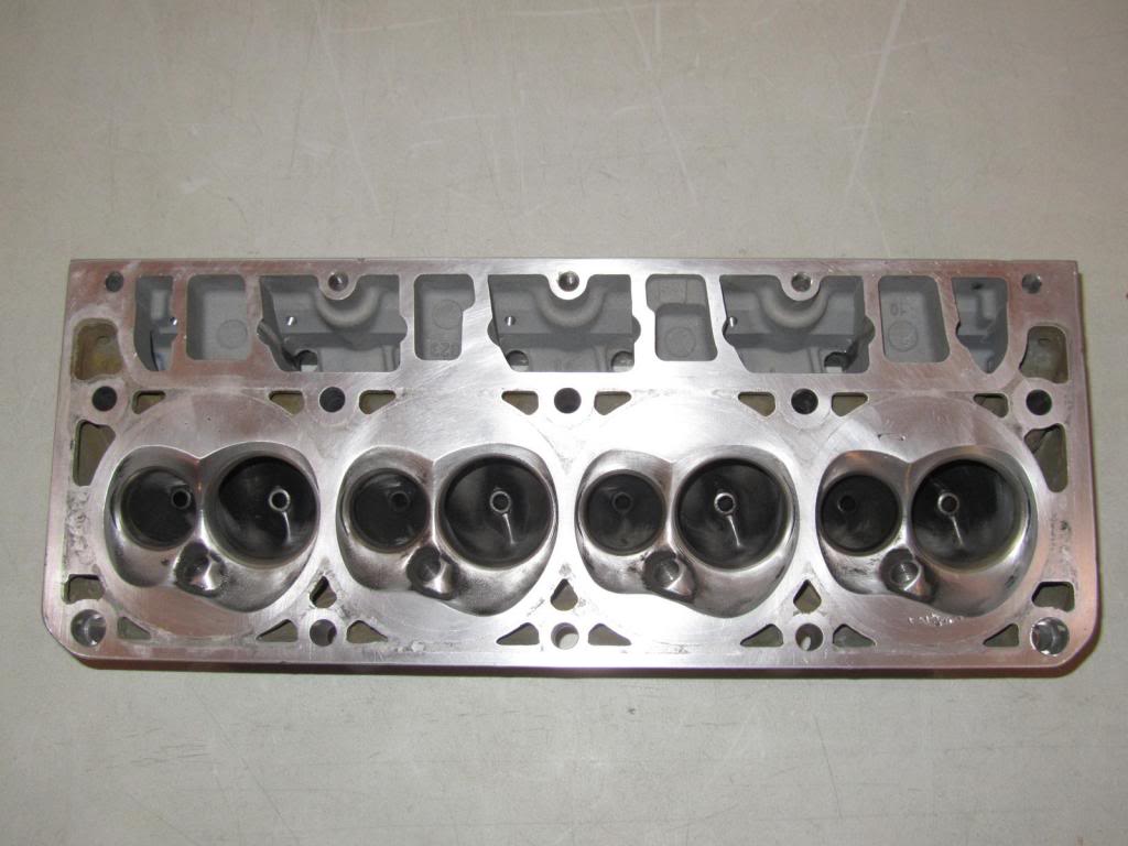

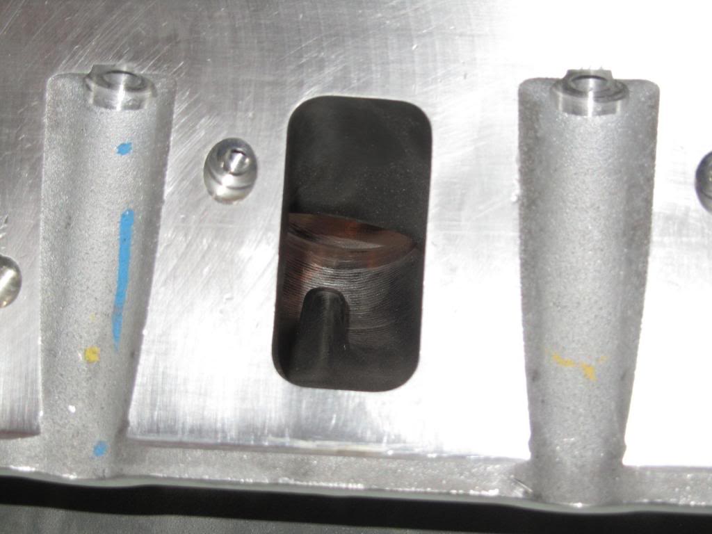

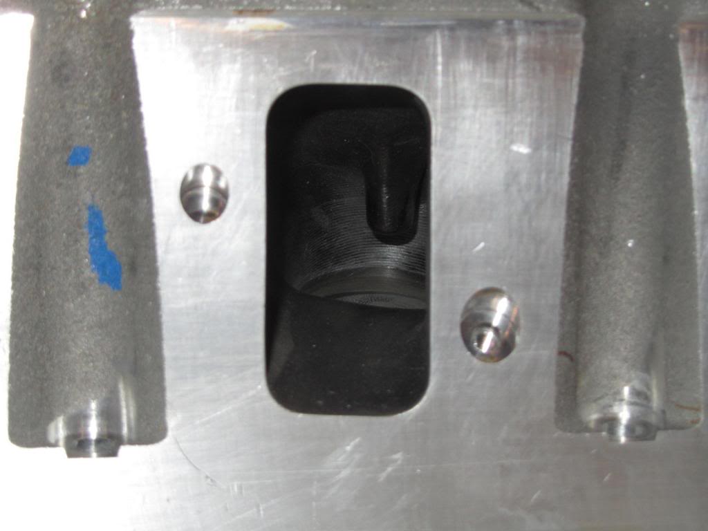

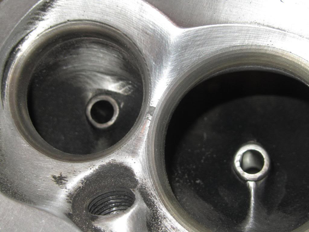

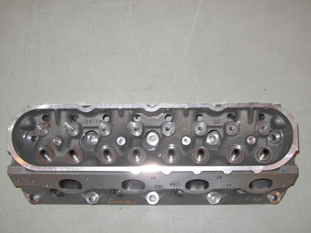

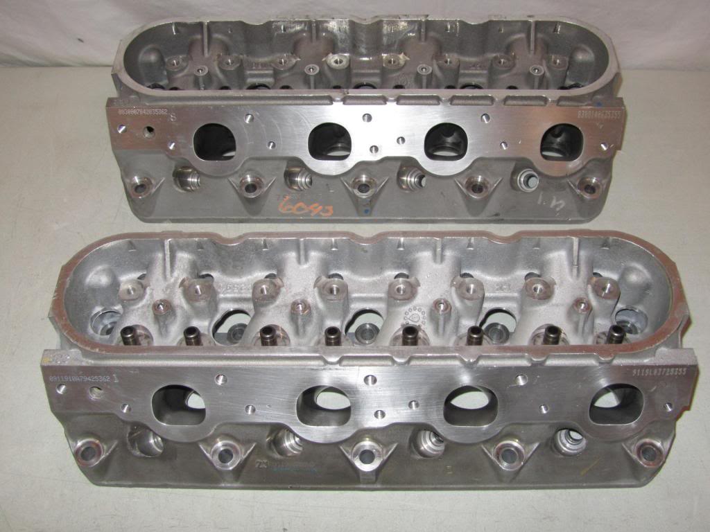

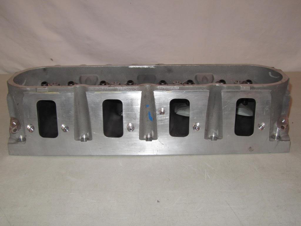

I picked up a set of cnc ported 823's valve size 2.15 1.55
What length valves do i need to run and what is recommend for a spring.
the cam goes to .575 lift
Figured i would run stock rockers with updated trunions
