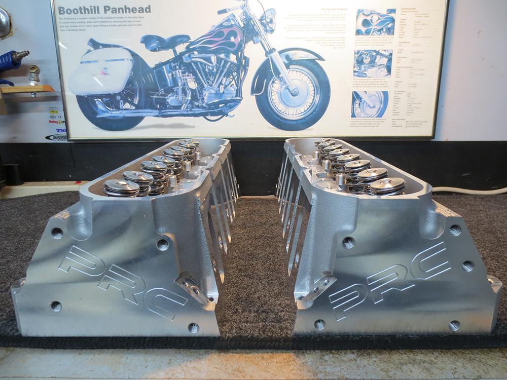

Originally Posted by nightbasser73
Thats some pretty good compression. Got me to thinking now. What head are you running and which head gasket?
Texas Speed PRC 225 heads with LS9 ( 0.055) head gaskets. Wish I would have went with a 0.045 thick head gasket for better quench. A tighter quench helps control knock and may allow for a skosh bit of extra timing.
