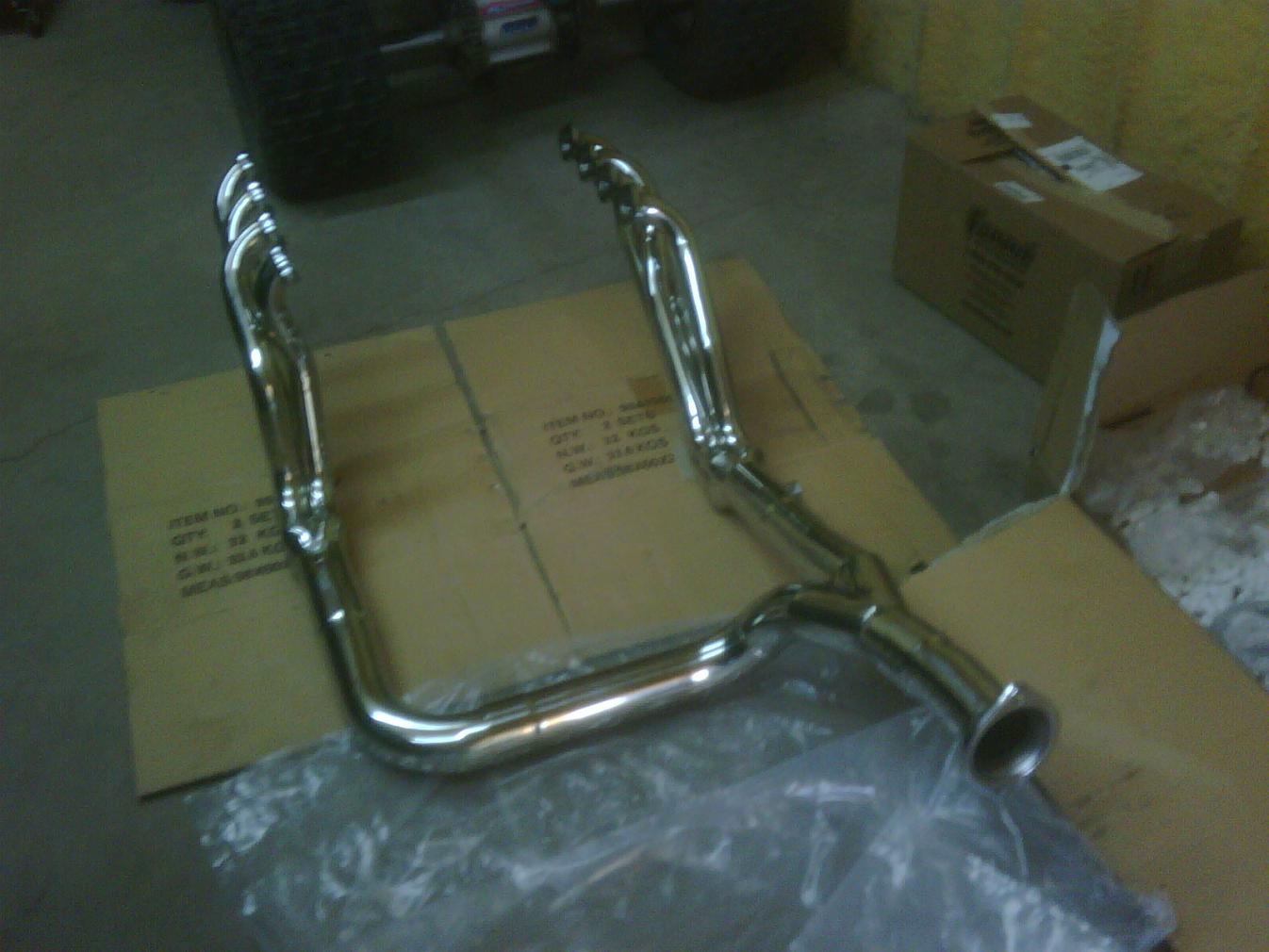

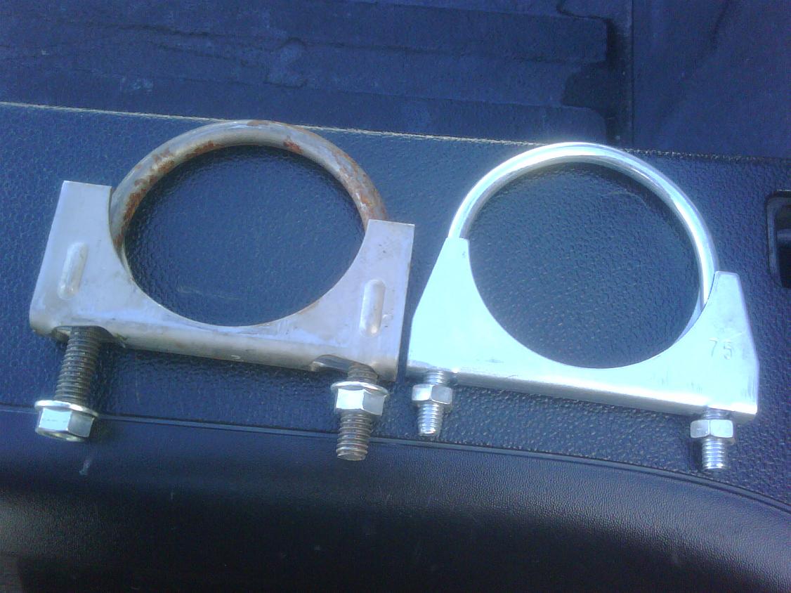

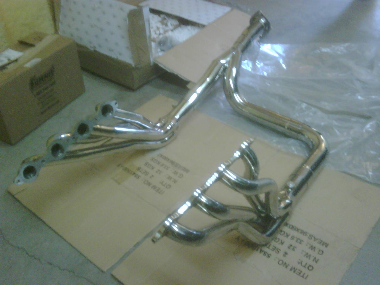

Im gona install em tomorow, i found on forums the clamps are bad that come with the headers, i bought bigger ones already... I think im ready for the installation.... I will let u know how they fit....

man it makes me wish i bought a set of these instead of my paceshitters these look ten times better plus they wont rust

Pretty

how much did headers and y pipe run u ???

Shouldn't you use bandclamps?

+1 The clamps that you have pictured will crimp the pipes together and make it impossible to ever pull them apart. I'd highly recommend using band clamps instead.

Nice looking headers! I have to agree with the others, use band clamps, you will be glad you did someday.

get the band clamps

Those are purdy! +1 on the bandclamps!
EDIT: And post up pics of the install!
