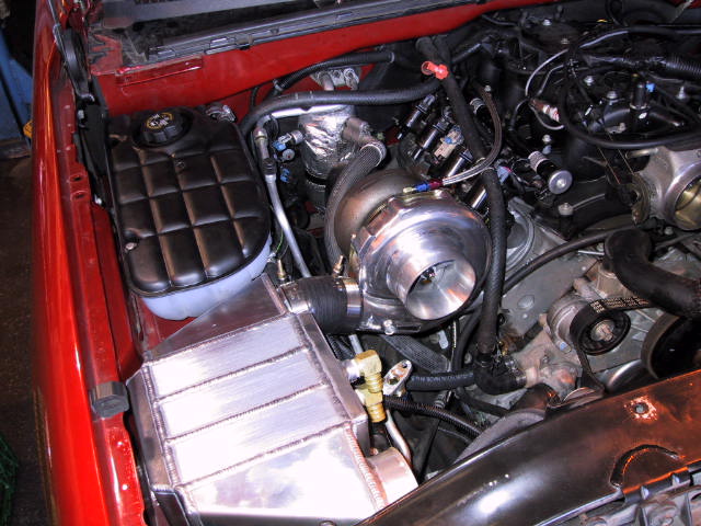

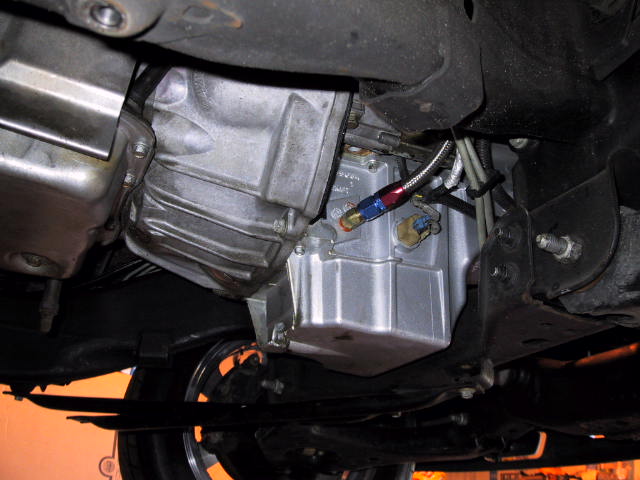

Hey Guys
Just wanted to post up some Pictures of the progress of my Combonation Motorsports kit
Finished the Cam shaft and Spring Change
Ran into a Few Fitment issues with the ac hose so i yanked it off
Gonna end up cuttin it and redoing the angle it sits on
I'll go into the Fuel install a later date
Have the Turbo in and bolted also the intercooler is in and Water lines for the heatexchanger are done
Have to finish the 4" exhaust Vacum lines Fill with oil and coolant
I think tommorow i should be ready to Fire it
jim

Looks good. 6.0L, right?

Yeah it's a 6.0l Bored .30 over with some Special stuff inside
Ported heads by absolute speed
This Truely has been a long road gettin here
truck has be done since December last year
I Got the last of my parts Last Friday I started things on Friday more or less
I'm gonna try and get some Video of the beast If all goes well tommorow

Is it stroked? 408?

I'd be careful about that AC line near the exhaust side.

Stock Crank
4.030 370Ci
Nice stout boost motor 9:1Comp ratio
looking to hit the magic 700number but we'll see
yeah that A/C line isn't there anymore we're going to Cut and tig weld it into the correct place
that will be a later on in the scheme of things

looking good, that drain line was easy huh. i think you can do 700rwhp with the right gas, i was thinking about hiting the dyno agian too, just to get a higher number than 497.
