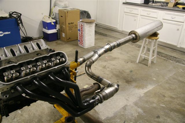

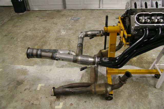

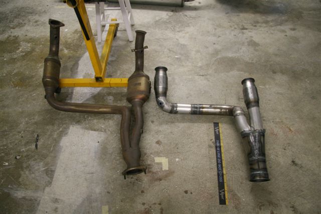

I've had very good luck using mandrel bends from Summit. My truck is different, but I was able put cats right after the collectors using Magnaflow Metallic core short-bodied ones. I cross over after the transmission, but of course that won't work with a transfer case.
Old Jan 19, 2007 | 10:22 PM
OLD BULL's Avatar
Joined: Jun 2004
Posts: 384
From: Houston,TX
Default y-pipe
Here are the pics. Pacesetters, 3" Flowmonster cats with v bands/stack breakers.
