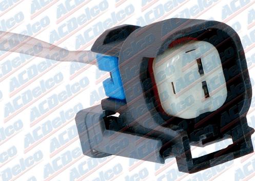

damn that sucks. I think I'm going to look at this AC Delco pigtail to adapt them to the stock harness:
PT1672
