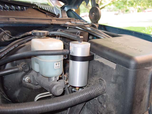

Hey guys, I just ordered my AMW oil catch can. Could you post some pictures of where you mounted it. I'm thinking of making a bracket to mount off the two ground strap studs that are on the firewall between the valve cover and the brake booster. Thanks.

I mounted mine on the other side, but todd @ AMW told me that most people mount them right to the fuse box cover and don't have any problems. Here is a couple of pics of mine:

Looks good. I did not even notice it until the close up shot.
