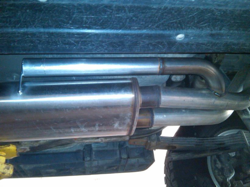

30" seems to work well for all the ones I've done.

That's vary interesting, were you guys able to notice a good difference doing this? Makes sence, mines bad between 1400-2000 rpm, it runs 2200 down the highway so its fine there but sucks driving around town. Guess ill need to try a slightly shorter one.

+1000 for the resonator tubes!
My truck is shown in KB's pictures above, it eliminated 90% of the drone. I highly recommend this mod.

It worked great on both my gas and my diesel trucks! My gas truck had 5 different exhausts setups till I did this and this was the ONLY thing that knocked the drown down. Lowered the db's by 5 in the cab acording to the sound app i have on my phone before and after. Was a HUGE difference!
