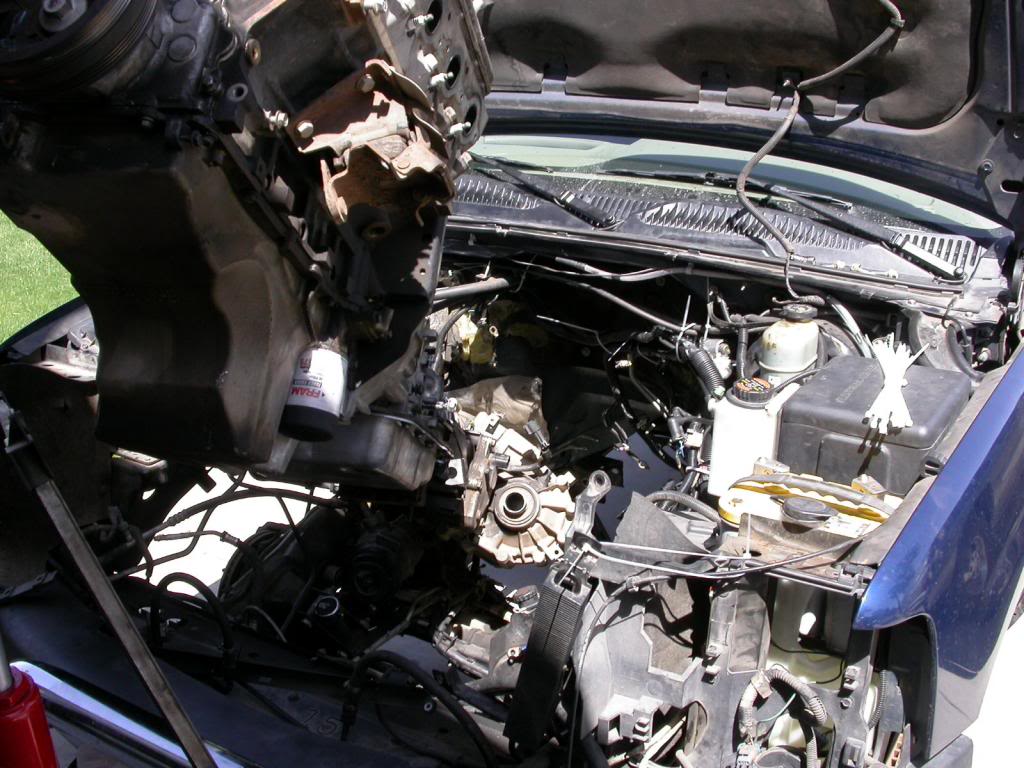

I've done it as one assembly before, will try to find pics. It is much easier to do it as AKlowrider says though, you have to disassemble the entire front end of the truck to pull them as one unit.

Here ya go.

Yeah, that doesn't look like a lot of fun Chris!

WTH I didn't think that cherry pickers could go that high lol. ^^^^
I would NOT do it that way again
I was surprised it worked, the load leveler was a bitch to move too since it was jammed up against the arm of the picker.
