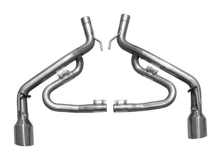

Seach for Helmholtz drone fix, on various forums. camaro 5 forum has a good read on it, and I think i've seen it on tech too. Are just trying to get rid of the drone, or quiet the exhaust down too?

Something like this.
Attachment 61300
this is what im doing, with a twist
