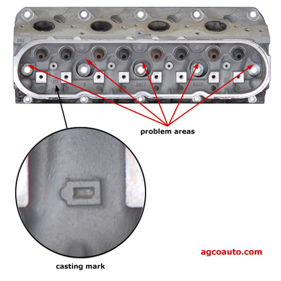

1. Who in OK is doing your diagnosis? Are you aware of the problems with Castech heads?
2. For $350 you can get Speed Engineering stainless headers and ORY for your truck.
3. The Hypertech is junk. If you don't believe me I'll read the stock tune out of your truck, then install the Hypertech tune, then read it out and compare the two and show you how little it changes. Plus it can't turn off the codes you will need turned off with an ORY. Even if you put muffler shop cats on it there is a good chance you will still set 420 and 430 cat codes. I see it all the time.
4. Here is the GM Bulletin on the heads. Although you would probably be getting coolant in the oil if that was the problem. I would inspect them anyway.

Some vehicles may experience a gradual coolant loss over time. A very low percentage of cylinder head(s) manufactured with an embossed Castech logo may develop a porosity crack in a very specific area.
Inspect the cylinder head assembly to determine if the casting was manufactured by Castech. This can be accomplished by inspecting for their casting logo located on top of the intake port, under the rocker arm support rail and in the spring deck cavity portion of the cylinder head.
Important: If the cylinder head(s) are Not a Castech casting, follow normal diagnostic procedures in SI to determine the cause of the coolant loss.
Refer to the following illustrations on how to identify Castech casting and/or the very specific areas of the cylinder head(s) for a coolant leak from porosity.
