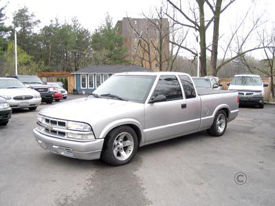

Is there a site that has this information about which engines are in which trucks/vans, not even gonna give this guy a price unless I know everything about this truck
"Hot rod sleeper!!! This gorgeous extra cab S10 has been professionally converted to a 5.7 V8 w/auto trans., ps., pb., a/c, CD, cr., tilt, keyless entry, p. moonroof, roll pan & more. Finished in flawless silver over graphite cloth. Only 58,000 km(only 38k miles)."
the install over all looks factory has a coldair intake, back tires are finished rubber all up in the wheel well. The sales man said the owner was the owner of a chevy dealership should proberly try to find out which one and try to get a hold of him and try to gather any infomation about it.
thats all I got for now i'll have more info on Monday I proberly have a while anyways they just got it and its customized so alot of people will look at it but even more will walk.

nice looking truck, could also be an LS1, that my friend is a 350,5.7 liter.( well actually a 346 c.i. that evry one rounds up).
