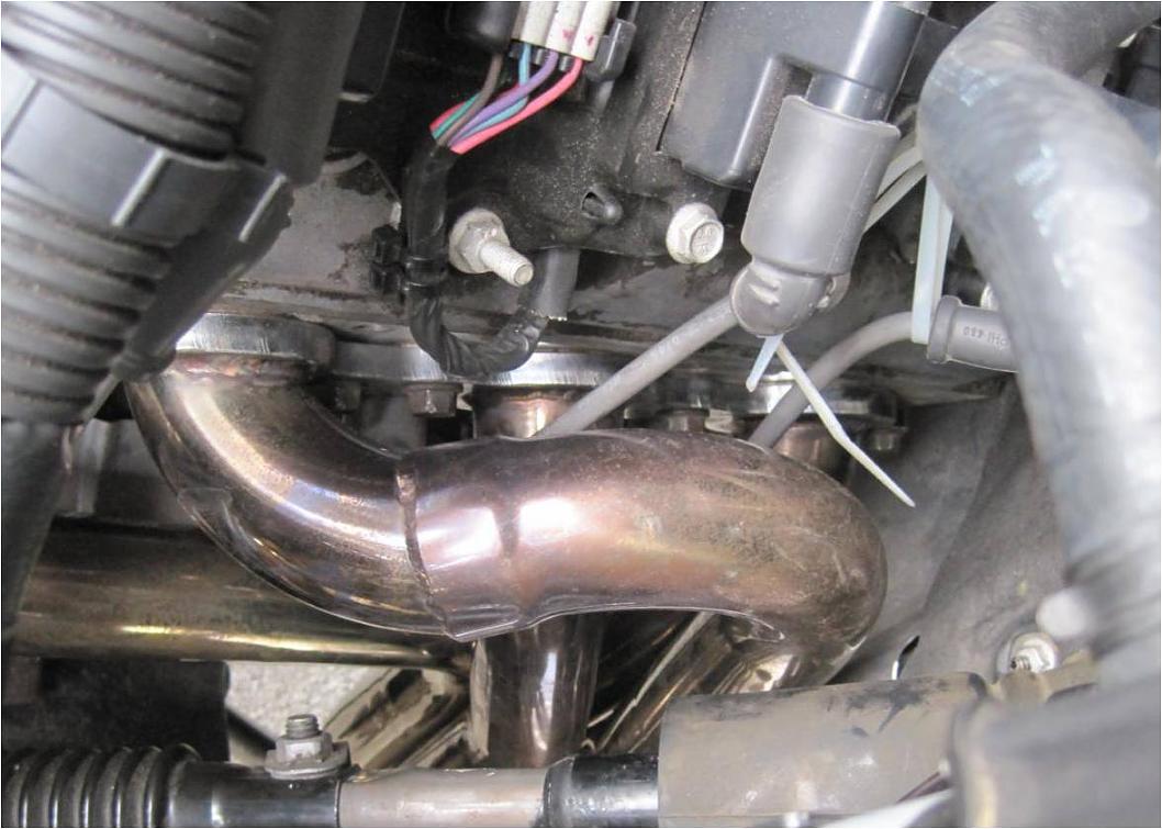

I just finished the install of my Ebay headers...Nice. The only issue I have is with the spark plug wires near the hump on the drivers side header. I either need longer wires to get them away from the hump or find some mechanical way to keep them from touching.
If you plan on installing the headers yourself... the Factory Y pipe was the hardest part of my install. I only had a lil propane torch to heat up the exhaust manifold bolts.
Ebay headers (from DNA Motoring?) didnt come with instructions, but relatively simple to figure out. One note...both headers install from underneath.
I hope this helps

Originally Posted by sand man
Here is the pic of the temp fix on the spark plug wires to keep them from touching the Hump on the Header

Whats up with the Mickey Mouse ear on the driver's side header? It looks like it makes a lot of problems with the plug wires.
That's the old style Dynatech, current style OBX/Ebay stainless #3 primary, and yes you have to get creative with either home made brackets or zip ties or you will burn up some wires.

yeah, i saw the bracket someone posted, but whats it for? Clearance or something? Optimal length? Just curious.
