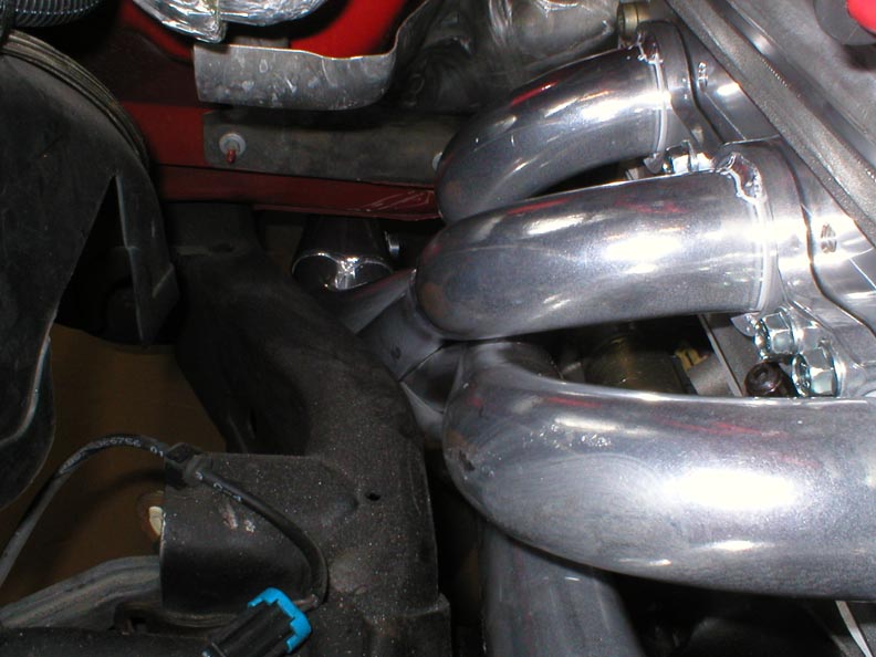

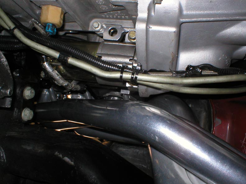

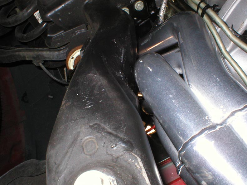

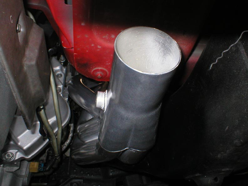

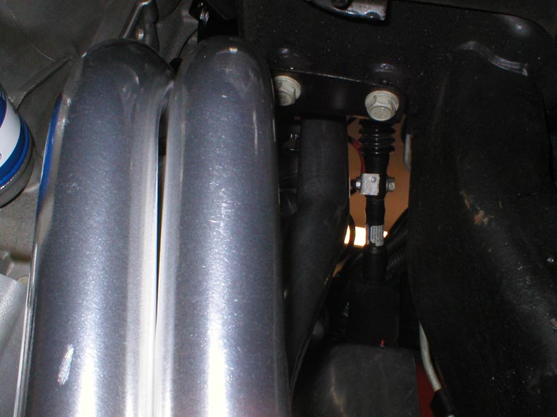

Got the headers back on for the final install. The driver side is still a good fit but I did have a little bit of problem on the passenger side. During the trial fit there was a 1/4" at one point where it passed by the chassie. I guess the coating process relaxed the bends and it moved too close not to hit during engine movement. I have seen Dynotechs do this after heating up a few times. I dented in a small spot on the chassie and it's good to go now.
1slow01Z71: Pics are hard to take and show what you need. Tuesday I will have a 4wd to compare and take measurements for you.
Attached Thumbnails Got my Kook's back from the coater (pics)-hddr-fit-008.jpg   Got my Kook's back from the coater (pics)-hddr-fit-010.jpg   Got my Kook's back from the coater (pics)-hddr-fit-012.jpg   Got my Kook's back from the coater (pics)-hddr-fit-014.jpg

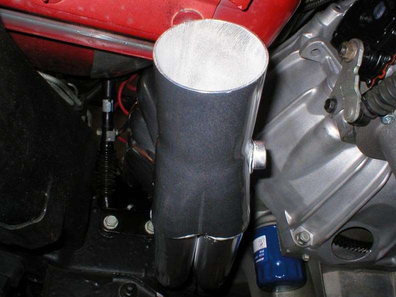

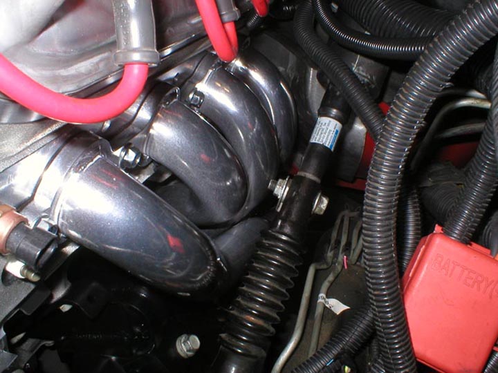

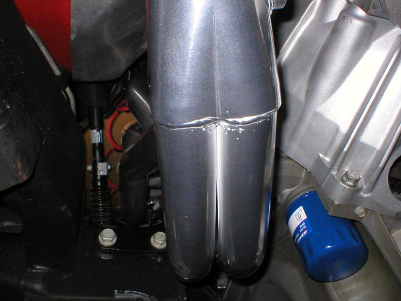

Some more pics....
Attached Thumbnails Got my Kook's back from the coater (pics)-hddr-fit-007.jpg   Got my Kook's back from the coater (pics)-hddr-fit-009.jpg   Got my Kook's back from the coater (pics)-hddr-fit-016.jpg   Got my Kook's back from the coater (pics)-hddr-fit-001.jpg   Got my Kook's back from the coater (pics)-hddr-fit-004.jpg

I looked at a 4wd side by side with my truck today. The Kook's will not even come close to clearing the front driveshaft. They drop down more to the front than the rear which comes down right on the front yoke/driveshaft.
