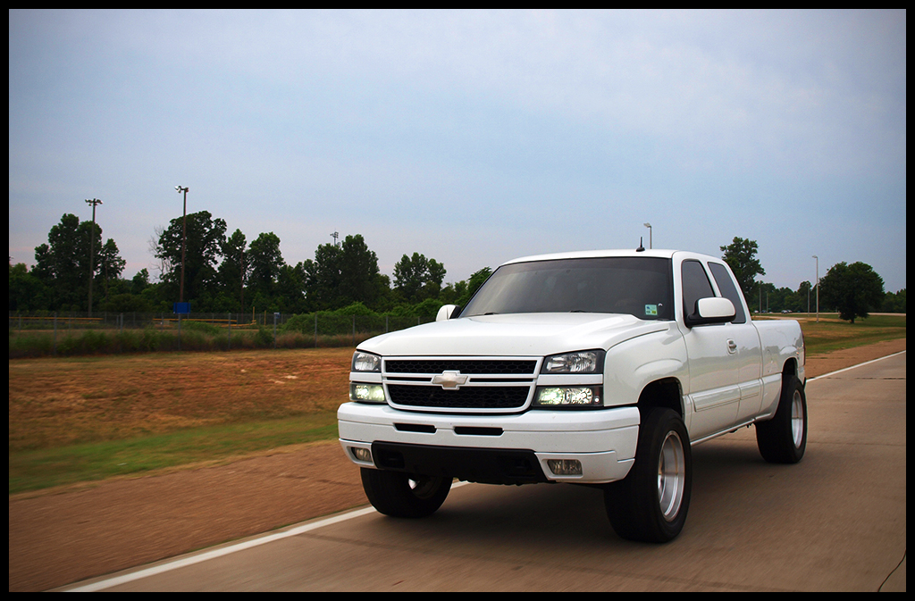

4.30's wouldnt be too much? i do a decent bit of highway driving too. will be keeping 33's.heres the truck
