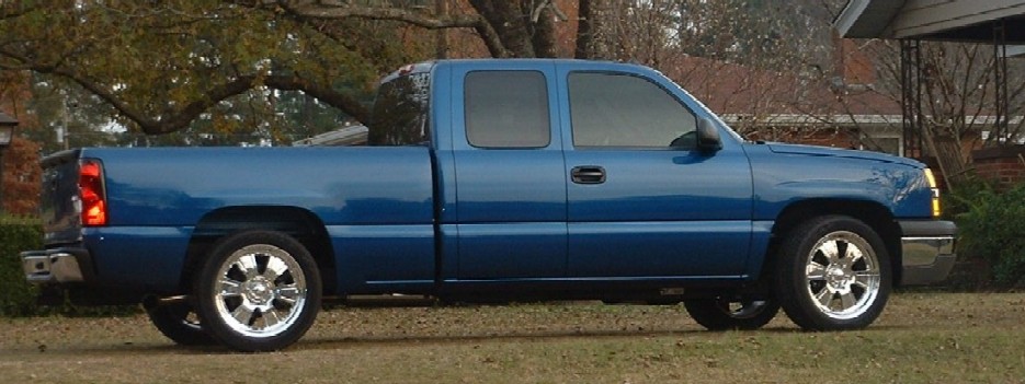

Here is your truck...It is an 04' ECSB with a 5.3, 3.42 gears, 20's. The only mod you have is a Magnaflow SS catback. It is a daily driver, object is to get best mods without any serious mechanical needed.You are not mechanically inclined and do not know a local shop or person that you have found that does the kind of mods discussed here (cams,gears,etc.)I am only 130 mi. from Atlanta though. Just put that in for possible referrals.... Act like it's yours and tell me what you would do. I definitely want to be quicker than the next guy, but at the same time the truck only has 3700 miles on it. Warranty? BTW my dealer says CAI's (k&N, Volant) messes up MAF sensors! You can see what I'm dealing with. Don't flame if you don't want to participate. But then again after some lenghty lurking I know this is the place to ask. Thanks in advance....Man this is long...!!!!???

truck looks good, I would like to say if your dealer is saying that fined someone else to do waranty work. tyhe first thing I would do is put a nece free flowing exhaust like the magnaflow on. after that it's hard to say. Do yu know how much money you would like to spend. one of the biggest and best mods would be to put either radix or sts turbo on it. the best mod for the money would be a custom tune pcm and a stall converter. Let's see how much $$ you have to spend to figure out a really good plan of attack.
