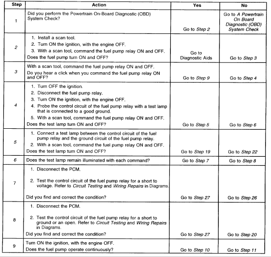

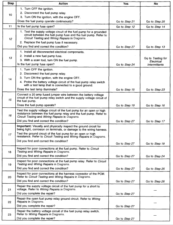

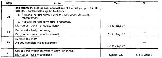

What's the possibility of a "not-so-firm" connection somewhere from the relay to the pump?
