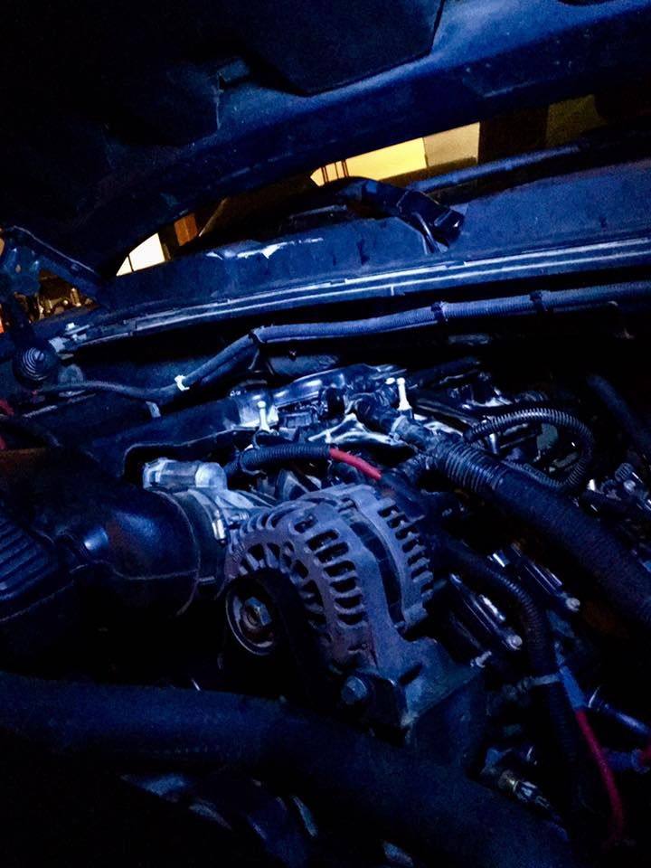

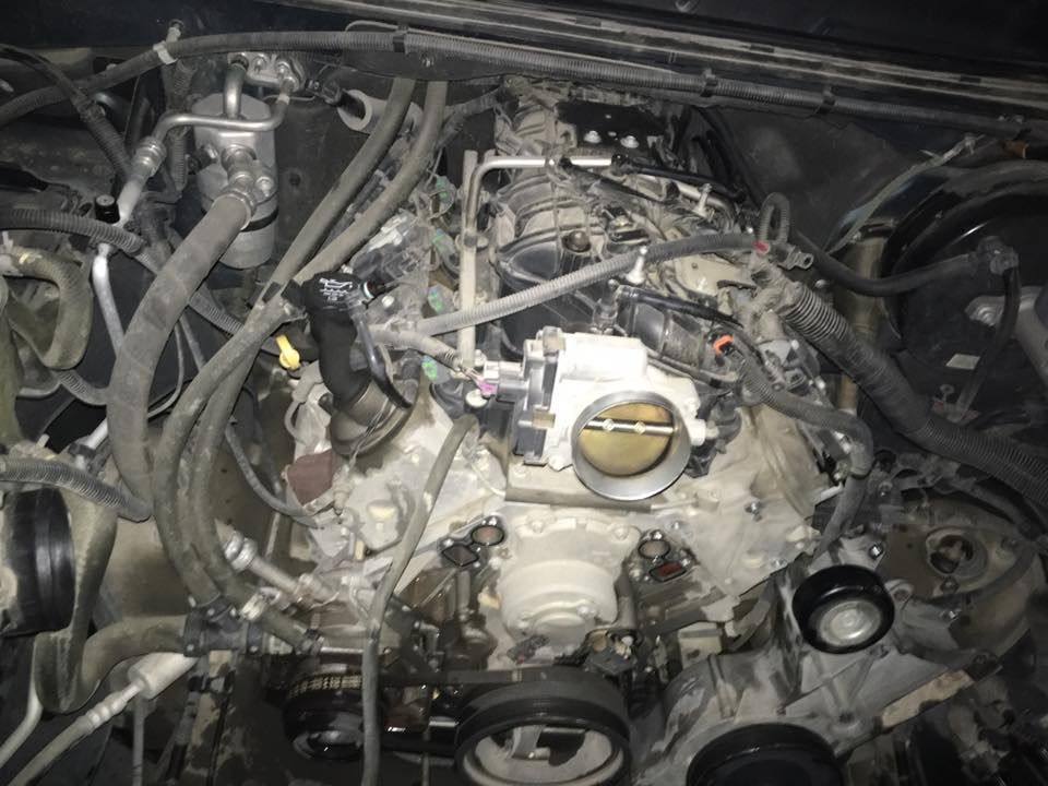

Haven't posted on here in a long time. Just finished up a heads cam build for my boy Smitty. Figured I'd throw a few pictures up and video of it idling. No dyno numbers but damn the truck really opened up and Smitty loves it.

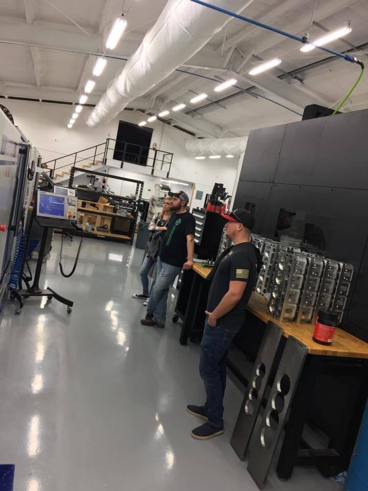

I started working for Frankenstein back in September once I separated from the Air Force. Feels like I haven't worked a day since, dream job.
Smitty and I worked a H/C package into the deal, turned out awesome. Jeremy Wiseman drove down here to Fort Worth from Southeast Missouri just to tune it, because I was on a time crunch. Tons of help from great friends!
Build is as follows:
https://www.youtube.com/watch?v=RhBxADS1mzY
DOD/VVT delete 5.3
TFS 216/220 cam spec'd via Mike Lough Racing Engines
Frankenstein Engineering Dynamics Stage 1 243s
Pacesetter LTs and O/R Y-pipe
Phoenix transmissions 2400-2600 converter for 6L80
