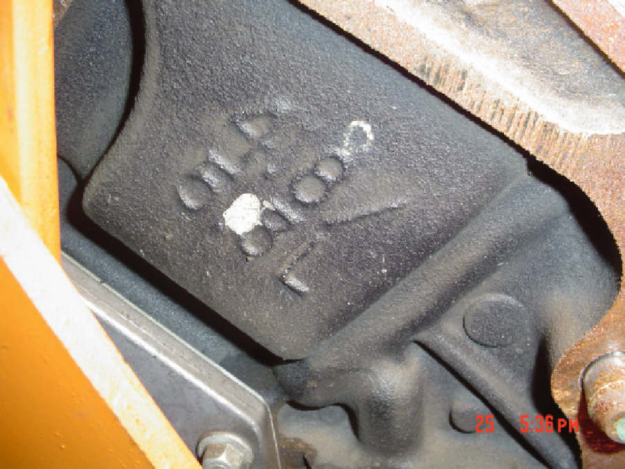

I think on the back of the block, maybe behind the flywheel it will say 4.8 or 5.3
not sure if i'm right or not but i think it says 4.8 an 5.3.but like they said the tops of the pistons are different.4.8 flat 5.3 dish.the pcm for the 5.3 will work with the 4.8 and vise versa. good luck.
I stand corrected, this was on the back of my 4.8
