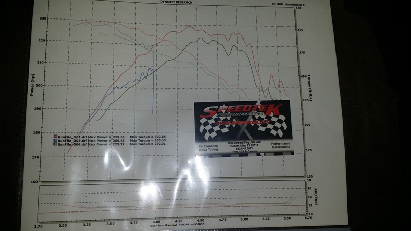

Not bad for what you have, but also makes the last L31 setup I put together and tuned seem like it has a good boost over stock.
Stock block 5.7 Vortec with the 395' marine cam, 1.6s, Tri-Y headers, stock 1-ton cats, muffler, and exhaust, through a 4L80E and 3.73 geared 10.5" 14-bolt. 2nd gear pull with the converter locked. The blue line was an attempt at a 3rd gear pull but the converter was unlocked and hit the 98 mph speedlimiter pretty quickly. It has a duramax fan blade and March underdrive pulleys as well.
