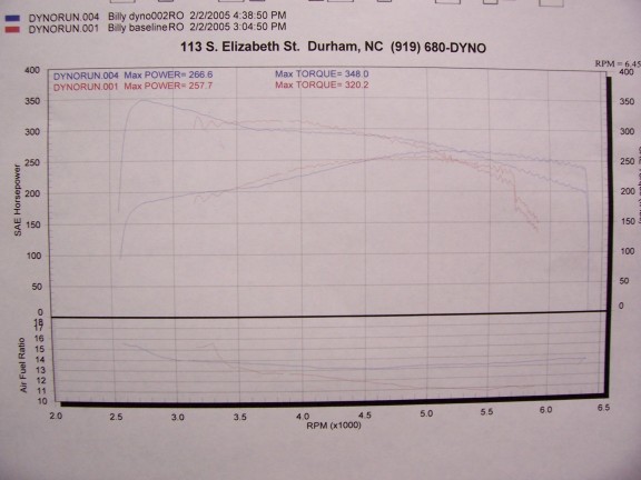

I ended up getting 257 to the wheels
on my first run
afr was below 11 and my timing
was 39*
it was also falling off real hard after 5500 also
I had Jeff Creech go back through and correct
all the mistakes that had been made
on the final run we hit 266 with only 24*
of timing
it pulled way past the 5500 where the first one died
This guy was great ,he took his time and explained
everything to me
There was no rush on anything whatsoever
once my truck hit the dyno
thats all that mattered
This guy sets the standard
My truck feels 100 times better now
I finally see what guys with hands on and dyno tunes are talking about
this thing rips now
I swear words cant even explain the difference of the 2
now its all I can do to keep from roasting the tires
damn its good to have my truck running like its supposed too
just glad it didnt blow up
Im ready to hit the track now and see what we cant do about that
tired *** 14.25
of timing
probably a bit low....but i wouldn't worry seeing as it was tuned and you notice a sotp difference.
go run it
Old Feb 3, 2005 | 05:13 PM
Kano's Avatar
Joined: Oct 2003
Posts: 1,612
From: Winston Salem NC
It was a dynojet
I could really care less about numbers
the difference in the tunes is night and day
judgeing by the pin-you-in-the-seat-o-meter
Im very confident Ill hit 13's now

heres the sheet

his name is jeff creech
Hes done work all over the place
From what I gather he knows people all over
Theres a guy flying him out to Maryland this week to tune his vette
Hes been in it for a while tuning everything but mainly
lt1s and ls1s
As far as mail order tunes I gave it 2 chances and neither one was right
even with logging.
My luck is not 3rd times a charm,its 3rd time and it breaks or blows.
so I just wrote it off as experience and will just have to get that 500
back from the better gas mileage
I was getting 12mpg before BTW
Im still amazed 39* and 11 AFR. butload of timing and flood it out so it won't
knock thatll work
