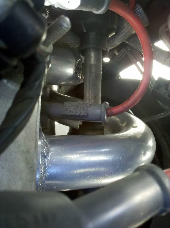

Do you think this dent is hurting my performance?

NO.....that's not enough for you to even notice.

Agreed, maybe on a dyno you might see a few(tiny bit) hp, but nothing your but meter will notice.. I would be more pissed I ahd to dent it, rather then the little hp it may take away...

Why did you put a dent in the primary to clear the steering column? You could have loosened up the power steering box and adjusted it so the steering column would rotate on a tighter axis and not hit the primary.
All you would have had to do after that is get an alignment.

about 1 hp loss

i would have but the owner of the shop owed me the install on the headers so i didnt get to do it myself, but thats what i get for letting someone else do the work..shortcuts.
im going down to EFI Alchemy today to adjust the tune so ill post up a dyno graph sometime soon
