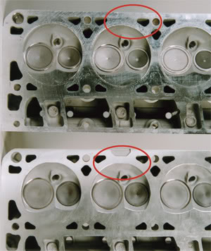

$200 to remove broken exhaust bolts ouch i paid $15 a bolt on mine when they did them
you can pick up a set of used 706/862 heads for 75-100
and as far as the head differences n gaskets with the older 862/706 castings
this should help
notch requires graphite gasket ...no notch use metal mls gaskets
Wrong gasket will leak water as soon as u fill it up
