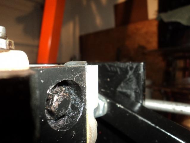

a little worried about how much the rear cover gasket sticks out above the pan surface. Probly seem paranoid about these covers, but i just dont want any oil leaks.
Mine was the same way, IIRC the part of the gasket sticking out makes contact right where you put the little bead of RTV on the oil pan gasket. Mine squished down when I installed the oil pan.
