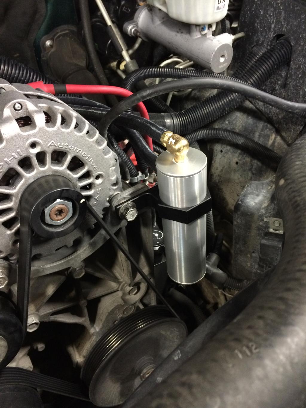

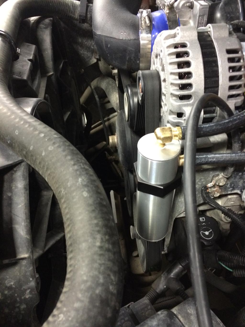

Went ahead and threw it in real quick at work. I was gonna mount it on the driver side firewall by the hydro boost unit but I liked it here better.

exactly where i mounted mine
