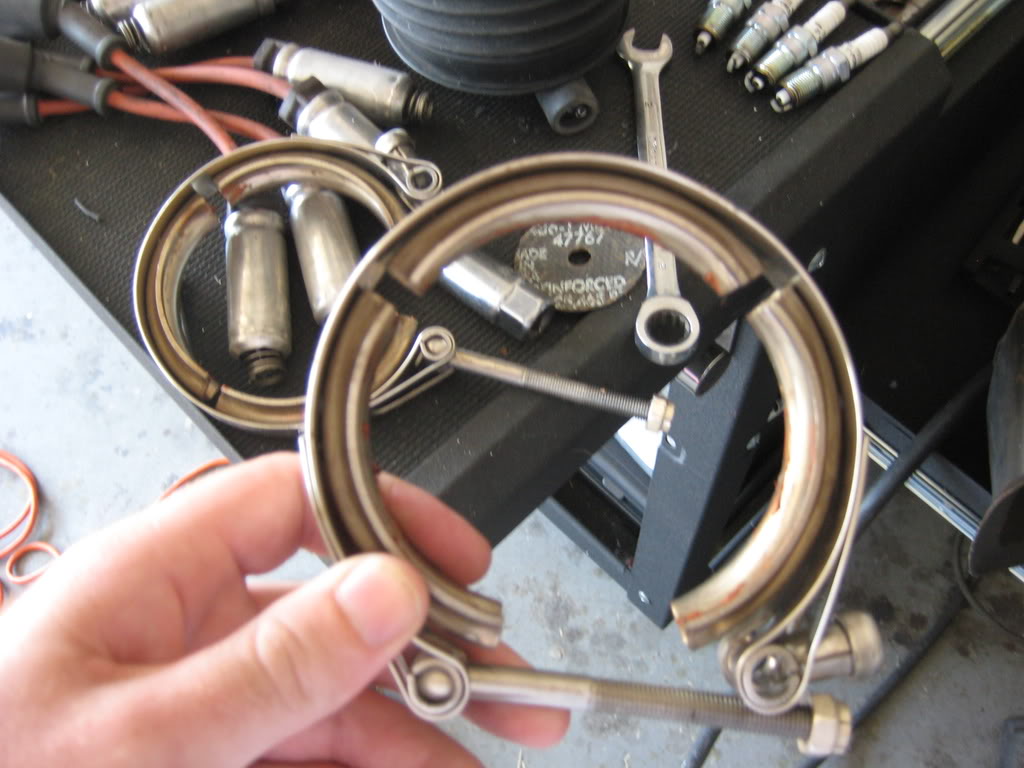

Your may or may not be leaking, take it apart and look for black soot....
This will cure all your problems and it is a hell of alot easier to take apart and put back together....
