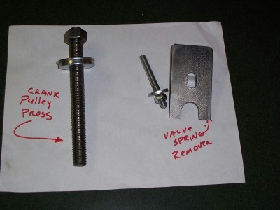

I made my own valve spring compressor
and allthread to press the pulley on "see atatchment"
I also used rod wrapped lengthwise with velcro
to make sure the lifters stayed up
all worked like magic
