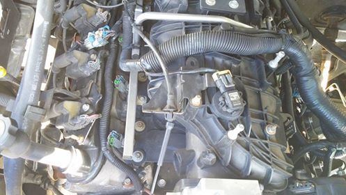

ive used my stock bracket on my GMT900 intake
Do you have any pics of how you mounted it up? Don't want to jack the OP's thread but I tried looking through your build threads and couldn't see it...

ill get a pic taken today at some point and post it but it bolts right up top

That'd be great thanks. I've seen a couple people use the stock NBS throttle cable bracket but they had to be hacked a little and rewelded and then adjusted for differences in cable length which is why I was just going to buy an aftermarket one like the OP...

no mods to it and been like this for 10k miles
Attached Thumbnails Cable throttle l92 intake-11008070_920684971314997_169062344495607652_n.jpg
