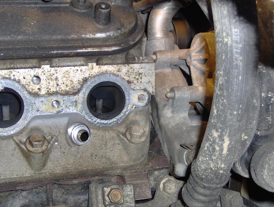

This is exactly what I'm going to do, Thanks for letting me know that it's actually possible, lol. Was wondering

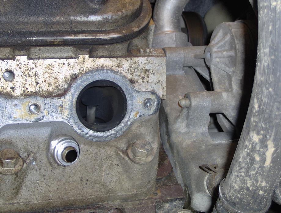

I started drilling at the bolt... and maan this bolt is SOLID, unlike the other that took 10 min. after an hour of drilling, i'm practically nowhere. I'll put a headset on with music and keep at it though. I only started getting a slight hole, you can just call it a dent really. Here are some pics I took through the wheel well, which is from where I'm drilling of course. The first pic is before I started drilling, the second is after.
