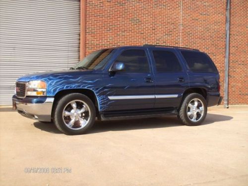

I have a stock 2003 Yukon, 4.8 with 3.42 gears.
Not looking for radical, just more TQ and midrange.
Plan to have a Blackbear tune at the same time, has Flowmaster exhaust and CAI. Other than that, untouched.
Also, with cam, will just the springs need changed?
thanks in advance.
