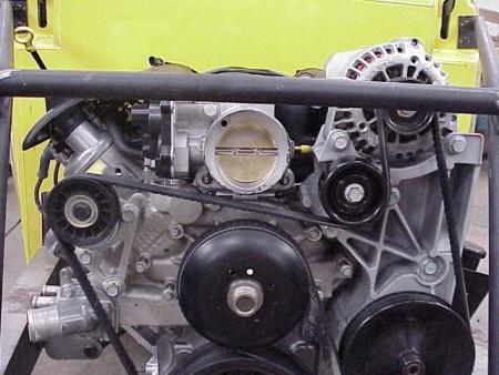

This is one way to route the serpentine belt.

I quess you need the LS1 water pump also for that?
I had my truck water pump modified to have the pipe in front like the LS1's. Nate at Nasty Performance did it for me.
