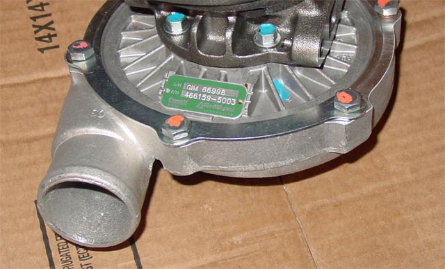

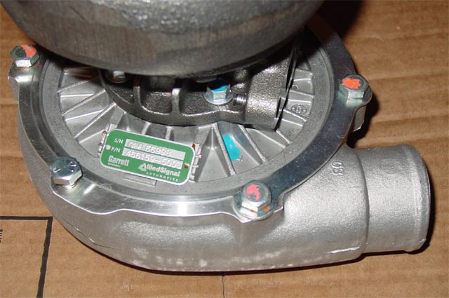

Ryan - On the intake reclocking thing it should be NO problem. It should be just as easy as loosing up 6 clamp bolts and turning the compressor housing to face wherever you want. Thinking of using your current intercooler setup with that turbo?
I'm kinda thinking the downpipe runs on the outside of the frame rail because it's probably tight with the crossover pipe and all on the inside of the rail. I don't know for sure though but, have looked very closely at that area before.
Check out the pictures below to see how easy it is to spin the compressor housing around to any position. Notice it's position compared to the serial# tag. That took all of 10 seconds to loosen the clamps up.
Um... I have always liked turbos. And that kit would plumb perfectly to my intercooler. I could do that in half a day. I would just have to make a new setup to go from the intercooler to the intake manifold that incorporates the MAF. That might take me two days tops lol.
