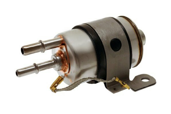

What regulator do you have?

I've got a corvette filter with a built in regulator that I put on when I did the tbss intake swap

Could just be a bad filter. I never heard of a pump screwing up the corvette filter but I could be wrong. I have the same setup but my pump isn't as strong as yours but I do have a high pressure pump. I have had this setup for three years now.

ok wel I put a regulator on and set it to 60psi and its still missing even at very light throttle and its also does it while cruise is set but its never a continuous steady miss it sounds like it wants to run good but something is just not letting it so itll just through random misses in the like itll miss twice in a row run good for a sec miss once run good for half a sec miss three times run good for two sec some thing like that if that makes any since to you guys. I ordered me a scanner so am gonna try that next and see if I cant find what the problem is.
