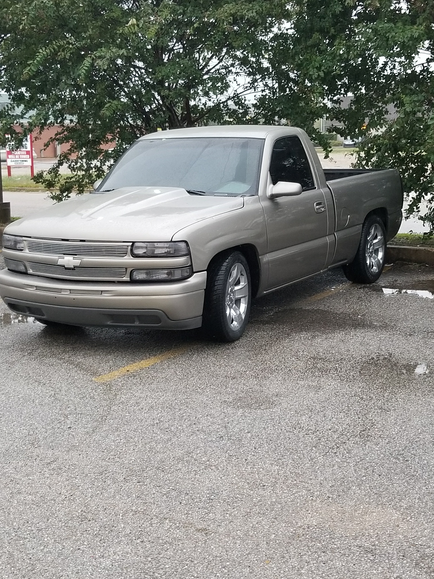

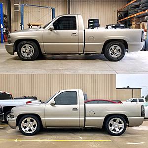

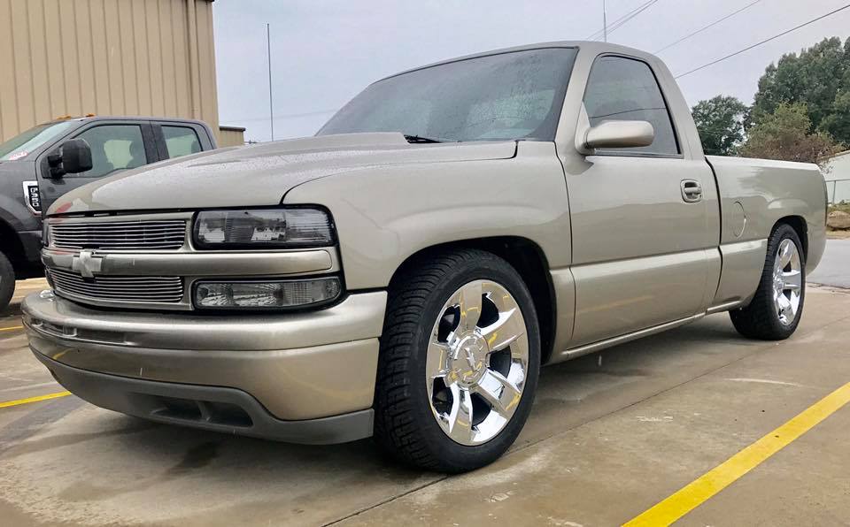

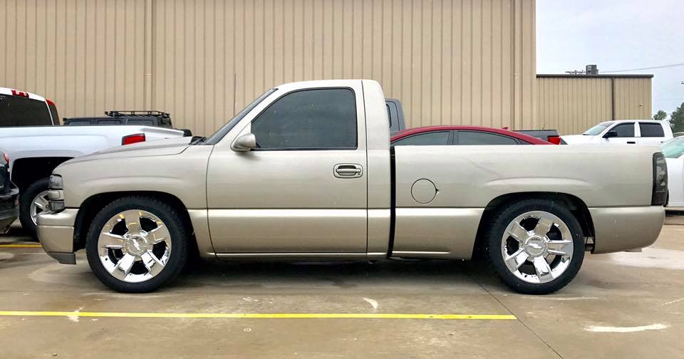

Owner of a 2000 Silverado 1500 with the ever so powerful 4.3L. Vehicle has 277,000 miles on original engine/transmission. It was the first vehicle each of my three children drove when they turned 16, and is now my daily driver.
Truck is ready for an engine swap and I want some more power. I won't be drag racing, but I'm not opposed to driving a fairly powerful vehicle as a daily (my weekend car is a '12 Grand Sport).
All that said...what would you guys recommend swapping to. I'm not mechanicially inclined, so I will be farming the work out to someone here in the Memphis area. As far as budget....I don't want to put a ridiculous amount of money in the truck..Somewhere in the 3-5K range probably. I've already got more money than it is worth in it.
Any advice or links to similar swaps on the forum would be appreciated.

Nice looking truck! You could put a 310 horse 5.3 L33 in it or maybe something with more power, like a 6.0 LQ4/9. You'll need to overhaul/beef up the transmission if not done so already and that will absorb much of your present budget. What gear is in it?
