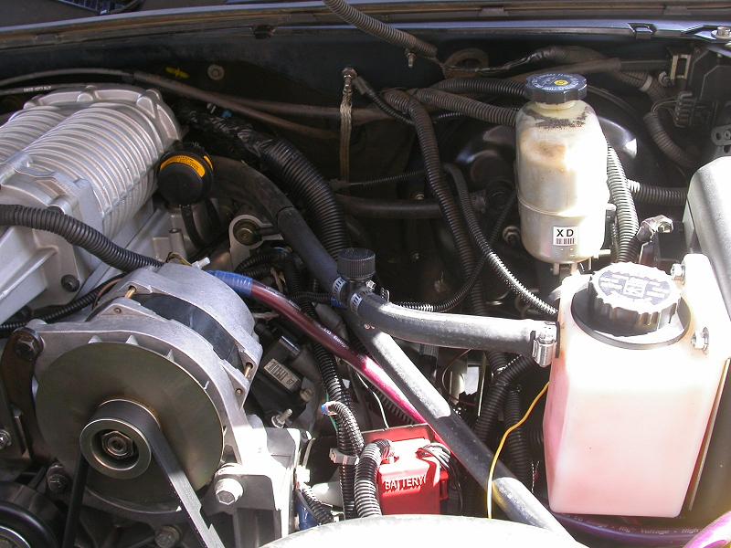

There's a big loom of wires that runs past the alternator bracket just to the right of it, the green wire in there goes +12V when you turn the a/c on. That's the wire that the Nelson harness taps into for the a/c signal. You can see it in the linked pic, there's a T-splice connector attached to a green wire that sticks out of the loom. The Nelson harness works the way you describe, turns one fan on high any time the a/c is on and the turn-on temp is not reached, turns both fans on hgih when turn-on temp is reached and the a/c is on. Keeps the a/c cold regardless.
