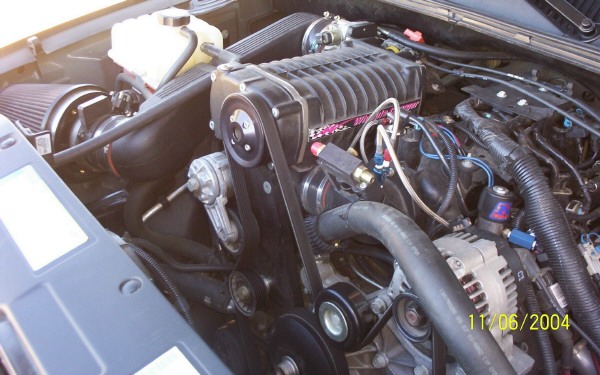

i put mine right where the aux. injectors are on the whipple spraying right into the intake manifold. hold on a minute and let me find a pic.
I think that is the way we are going to do it. That is the way I have been telling joejoe to do it also, but his mechanic says it wont work I just need to pull 2 more wires and the kit is all yours joejoe.

The stock pushrods wont last til 6300 the valves will start floating and we all know what happens soon after . I was think a radix setup for some reason. If it is the sidemounted whipple then just put it on the outlet side of the charger and be done with it. It would just be like sprayin on a n/a truck but with alot more air going through there. You will be fine. Dont go much over 6k with stock internals. You need to upgrade pushrods and valve springs before you can do that safely.
