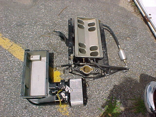

Here is a marine intake right after removale from a boat.

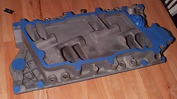

Compared to this mess lurking underneath the stock pleum cover. I call all that stuff that impedes airflow through the intake manifold "Injector Debris".
Side by side Marine left, truck right

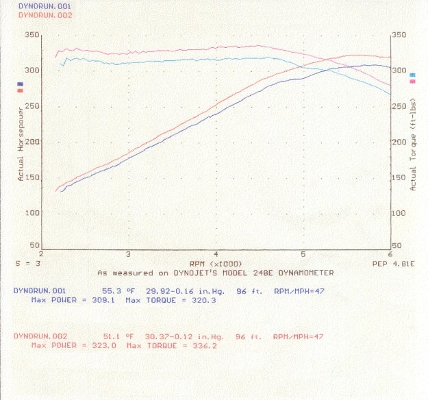

Vortec 350 dyno of Ramjet 350 intake with LT4 hotcam on a stock Vortec 350
A dyno of a Vortec 350 van with marine intake, custom PCm tuning, 206°210° roller camshaft, LT! Camaro stock exhaust manifolds. Look at that torque curve, or torque LINE.lol

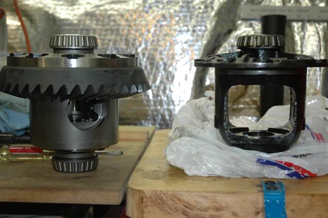

This is a stock open rear diferential carrier pictiured next to teh Eaton Tr track gear type traction aid. Look how much beefier the Eaton unit is. Obvioulsy stength is greatly increased. Your truck will have an 8.5" 10 bolt semi floating rear axle assembly. if you count 10 bolts of the dif. cover. If you get under there and find 14 bolts on the cover. That rear is a 14 bolt 9.5" semifloating rear end.
